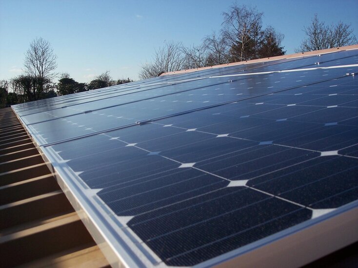

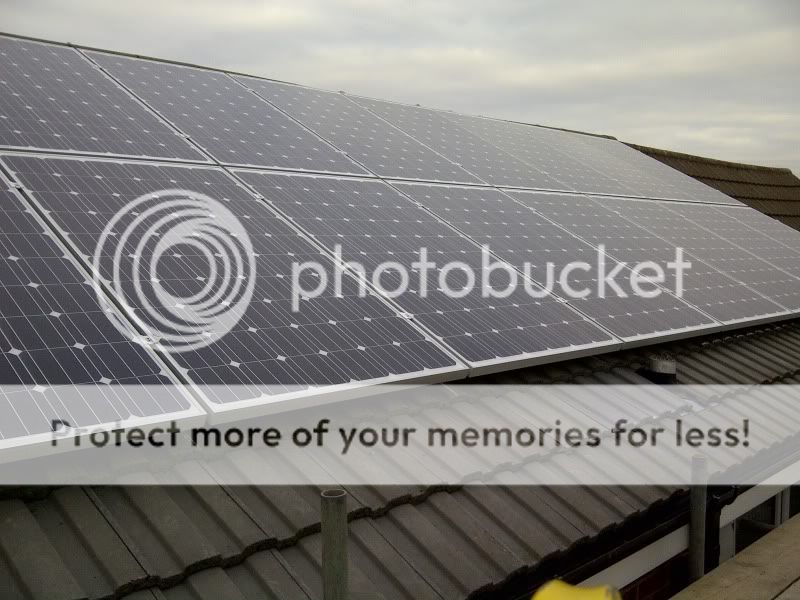

After attending a C&G 2399 course last year with the idea of becoming a MCS registered company by using my house as our first installation we then decided against it when the government started to mess around with the FiT. I then put the idea of an install on my house to one side but after considering the 21p tariff and that it would still make money and generate towards our electricity consumption along with the possibility that it could actually turn into 43.3p I decided to employ the services of Ploughcroft Solar to carry out an install for me.
This was installed today and I'm over the moon with the quality of work, considering I'm a fussy bugger.
Panels are JA Solar JAM6 60/200-250 (16 off for 4kW) coupled with a Fronius IG TL 3.6 inverter with a 20 year warranty.

Nice job - looks good as much as i dont like admiting it (ploughcroft are near me) just curious as i buy from the same supplier - did they drop your price for the JA? Coz you was going to have LG.
I think that looks really great, panels all lined up and fingers crossed for the 43.3.
I do have a couple of questions, they are for my benefit and not in anyway a critisism,

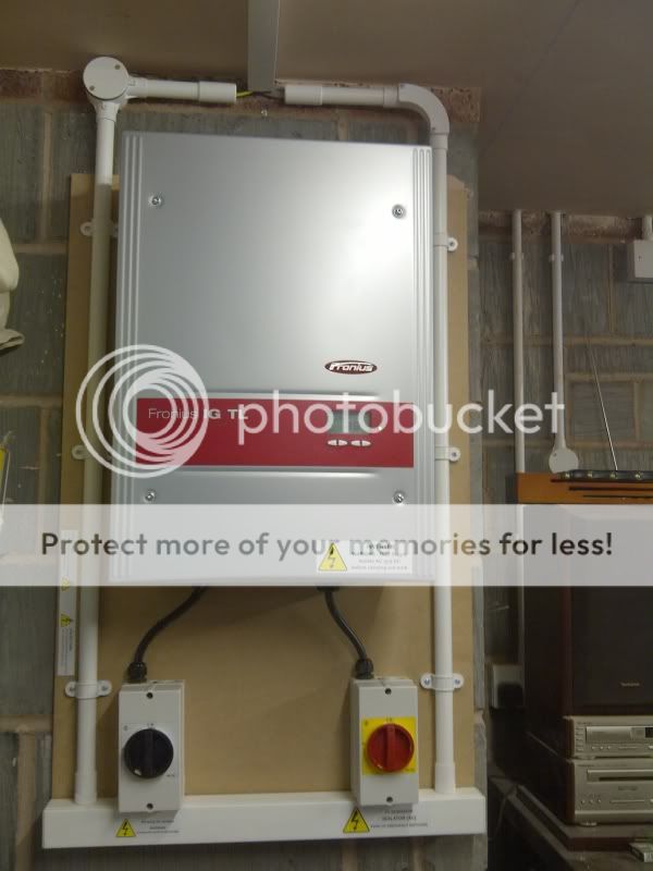

1. Why has it been mounted on an MDF board when there are fire resistant blocks behind?
2. Why is there only 1 DC isolator, have the joined the strings with Y pieces?
3. is there a reason for the 2 different right angle inspection pieces at the top?

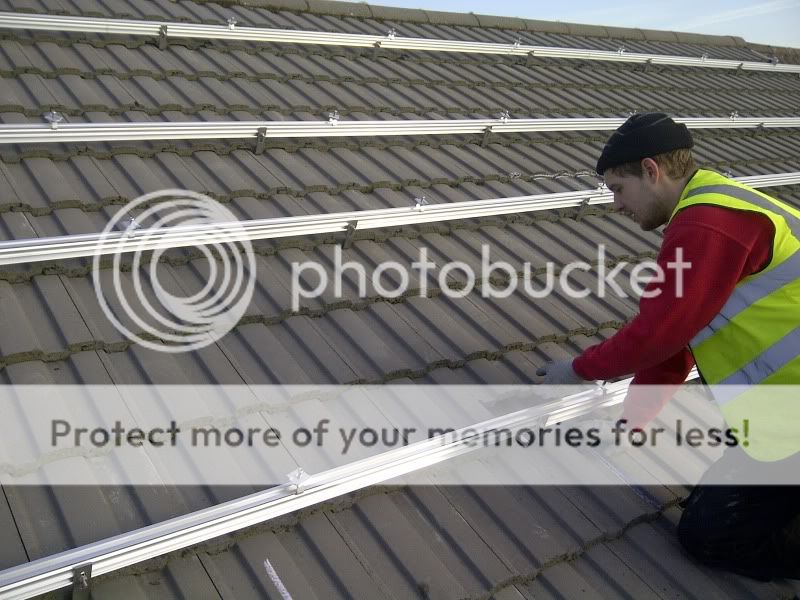

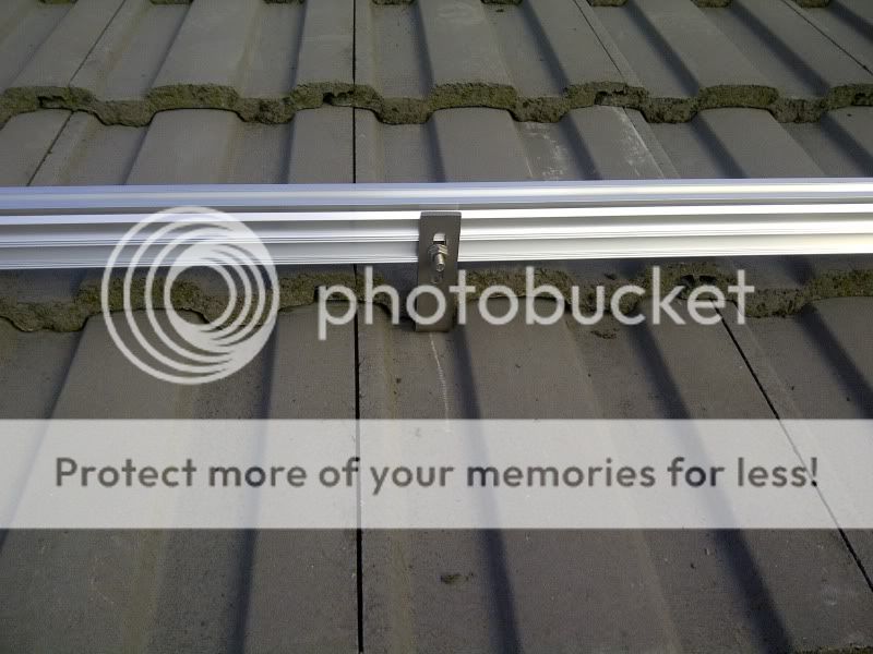

4. Those roof tiles look really great and flush, did they notch them to achieve this or just a decent bracket.
5. Are the rails Schuco, I cannot understand why we are supposed to fit the rails the opposite way to how yours have been fitted, all the manuals show the rail on the underside of the bracket, your way makes much more sense!
6. What did they do about earthing the array frame, I always find this a nightmare? Thankfully todays had a transformer

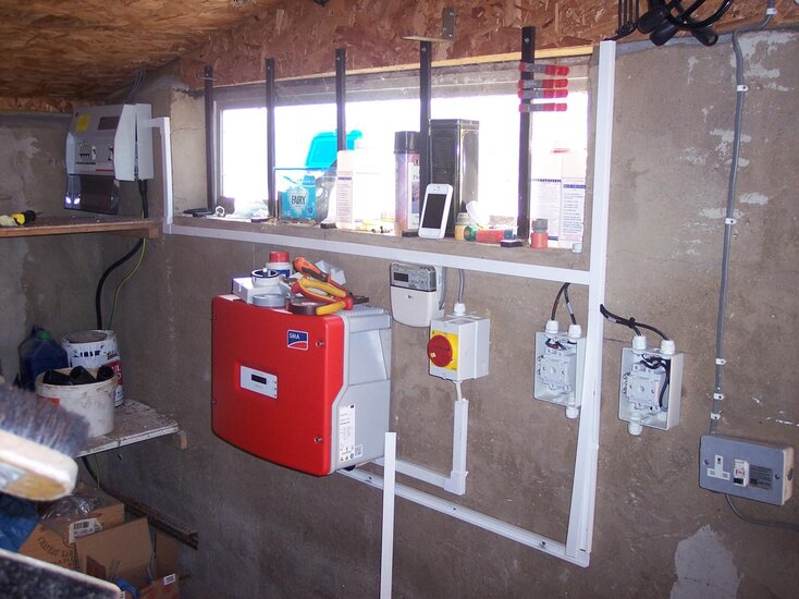

Heres mine done today, not as well lined up as yours, however I was a bit stuck with roof undulations and couldnt compensate.
I like the way the isolators butt up to the trunking, I will try that way, neater than what I have done!

LG were going to be provided by another company though he preferred to use a Fronius IG Plus 35 instead of the IG TL 3.6 I wanted. Ploughcroft ended up around £700 cheaper so I was more than happy to go with this current setup.
Not sure about that one!
1 string so no Y pieces, just connectors in the loft.
Yes, the inspection box has a back entry conduit from outside (Black 25mm external) to carry the string and 10mm2 bonding conductor.
I suppose he could have matched the right hand 90 degree bend but it doesn't really bother me.
No tiles have been notched, they must be a decent bracket. The roofer actually commented on how well they fitted.
I think most do this purely down to the fact that you are ensured a flat surface to mount on, it looks neater especially with all your safety stickers and your Solar PV systematics that you should have on display. Also, most mounting brackets / bolt go straight thro' anyway into the walls

One thing im going to add. A little quirk of the 3.6TL is in low light, like early morning or dull days the display may come up ERROR 307 this is perfectly normal and it occurs when there isnt enough irradiance to start up. Ive had so many calls over this!
