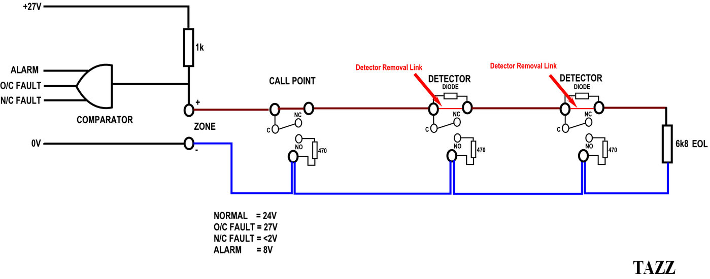

All will depend on what make of panel you are using....The basic method of fire alarm panels, is to monitor the cable as well as detecting a fire condition. Making a system, able to report a fault on the cable or device. The control panel has a comparator circuit, which basically measures the voltage, in relation to the resistance (ohms law, as Tels post) so in normal operation 6k8 ohms/24v = ok.. 470 ohms/8v = fire.. 0 ohms/27v = o/c fault....>6k8 ohms/<2v = n/c fault. Hopefully diagram will help
Fire alarms installation and testing Conventional operation - EletriciansForums.net
What does the first switch in that diagram represent?

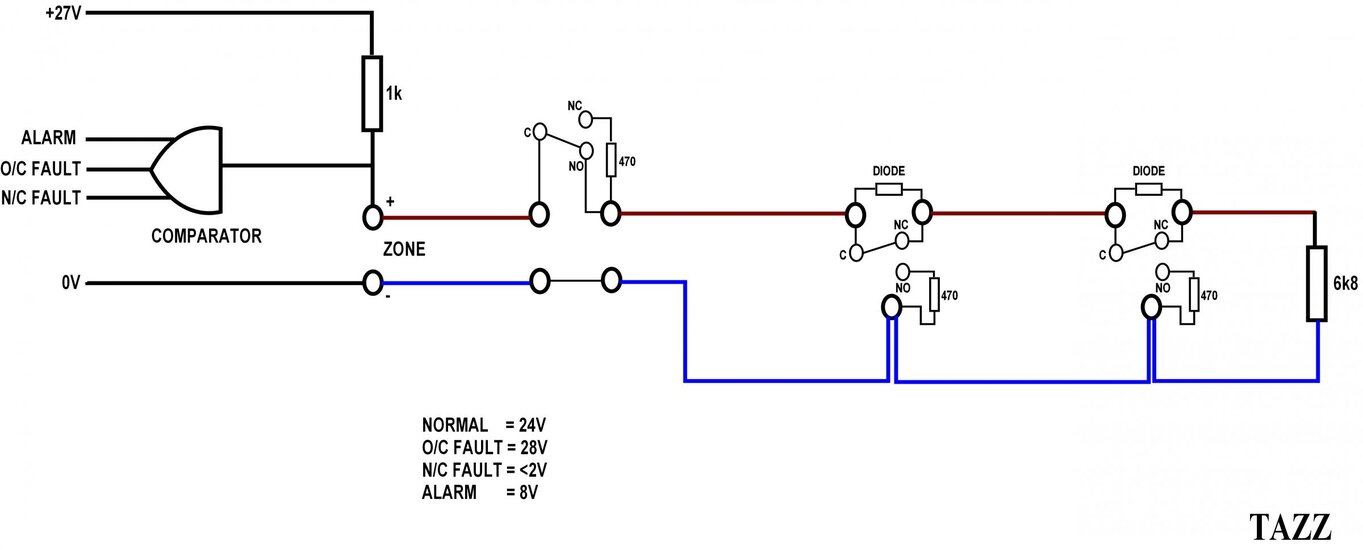

Unless I'm being daft it looks like it puts a 470r in series with a 6k8 which would raise the potential the comparator above 24V and show an open circuit fault wouldn't it?
Sorry I have made a mistake in this diagram the 470 ohm resister should be switched against the blue negative line as others are show......Thanks for spotting that Dave....updated
fine if the eol is a pure resistor. some are more complex and as such can't be read on a multimeter. hoewver it's easy to operate a call-point and get the expected 470Ω .
