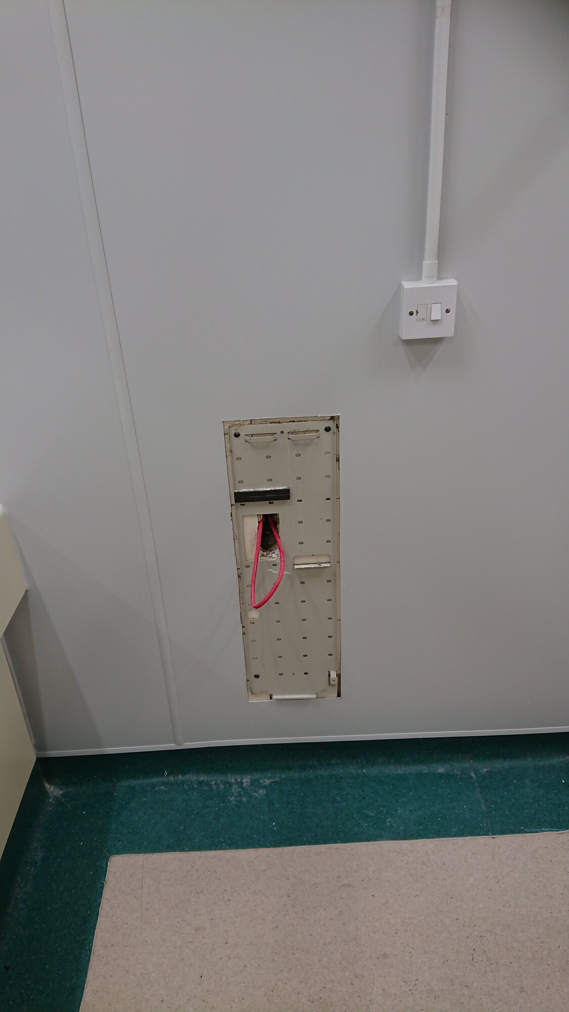

Hi all, this is just a question to put my mind at rest and to see if I'm right. I'm not a qualified spark and I'm not the person(s) involved with the work.... OK here we go!
My workplace (large Plc) are having the staff toilets done up a bit. A hand dryer was removed from the wall and chase made for the cable that was in a conduit.

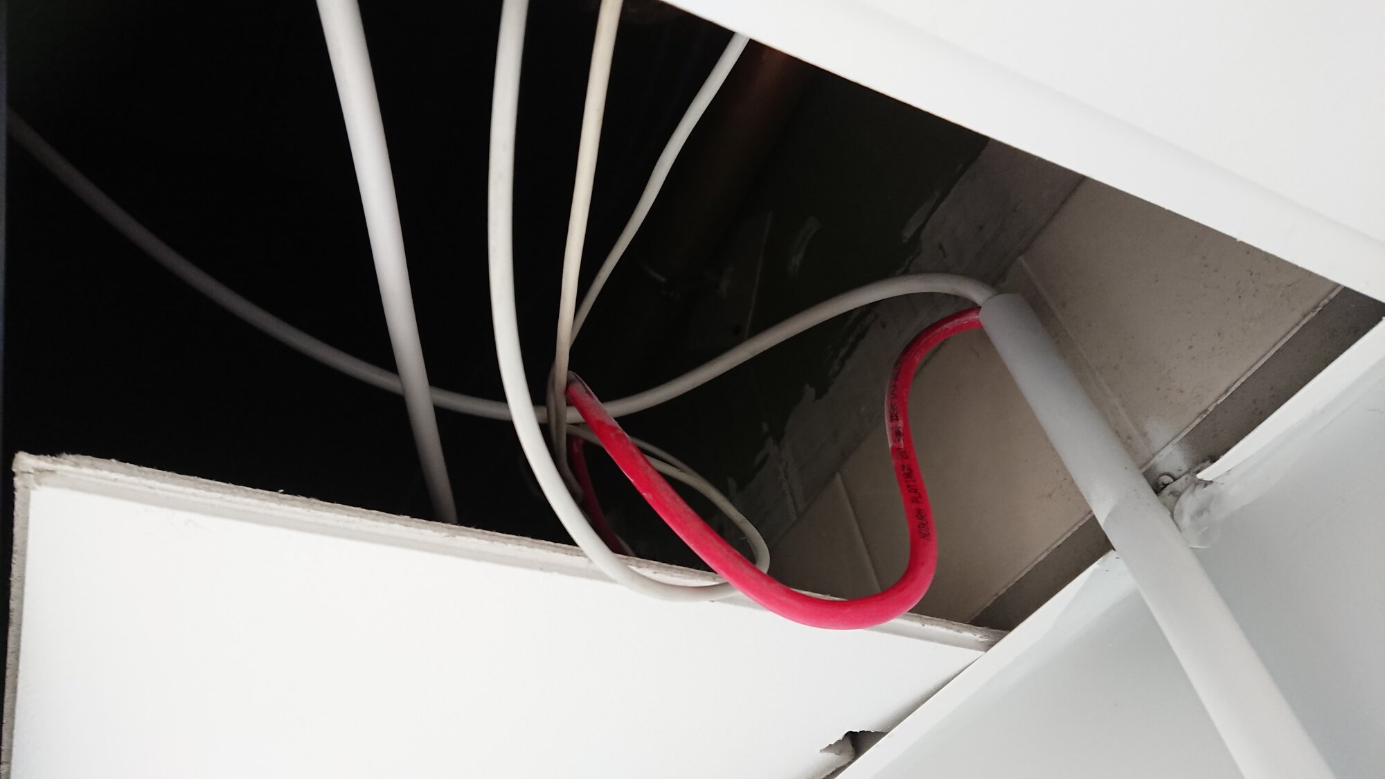

Got to work one morning (contractor working nights.) Wall had been clad over, out of the hole where dryer to be fitted a nice loop of what I'd call pyro!! (We are also having the fire alarm worked on.) obviously I immediately know the alarm won't be going there!
So why use an off cut of this to hard wire in the hand dryer?
I think the red cable is PF200? Its made up of red outer jacket, metal clad then 2x 1.5mm in a Rubery low smoke jacket and a steel earth or PC.
So is that right? I'd say no, and it should be PVC twin and earth 2.5mm.

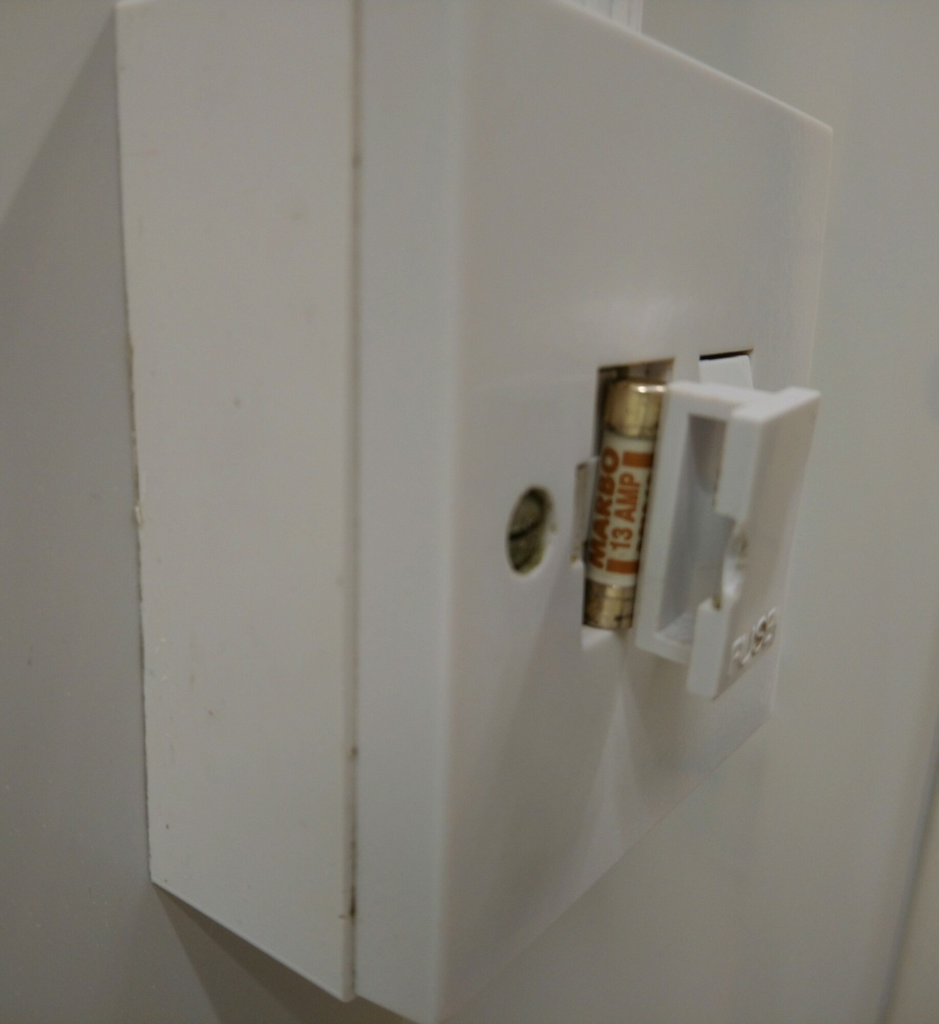

Our fire cable runs out of a fused spur with a 13amp fuse fitted.
Photos included and any views greatly appreciated. Thank you all. sketch-1644265523714.pngDSC_6959.JPGDSC_6965.JPG_20220207_204521.JPG_20220207_204439.JPG_20220207_204809.JPG
Why was the FP run in surface conduit when there appears to be a cavity, and should the switch be higher up to stop people turning it off or stealing the fuse?
It is a higher-spec cable than twin-and-earth in almost every way.
It's tinned copper, better than the plain copper of T+E, and larger size (equal to L & N)
Pyro (MICC) is something else entirely, with a solid copper extruded sheath and compressed powder insulation that can withstand heat up to the melting point of copper.
It's a strange and expensive way to do it, but technically nothing wrong with it

Personally I wouldn't be happy with red FP200 being used for non-fire alarm installations. The colour red is specifically to designate it as fire alarm. I would much rather it be any other colour. (That said, there are other cable types, e.g. 6491B LSF singles in containment.)
A galvanised saddle might have been better than a PVC one too in order to protect against premature collapse of wiring systems in the event of a fire.
