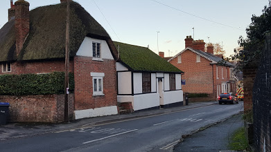

So first things first, just bought myself my first house 20151120_154608.jpg. 1920's build in Wiltshire. Should have the keys to it next week, can't wait.
