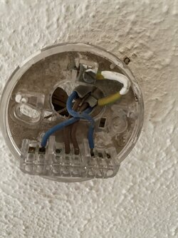

I’m trying to replace and old crown with a new spotlight.
I understand one of the neutral is a ‘live switch’ due to the extractor fan.
On my first attempt with 2 x live in L, 2 x earths in E and 2 x blue in N - The fuse blew.
I then put the live switch in L and now the fuse isn’t blowing but the light itself doesn’t switch on.
Any ideas?

The original rose has 4 connections. A permanent live, the switched live, neutral and earth.... you new fitting only has 3... you need another connector for the perm lives.
The switched live is blue, but should have a brown sleeve or tape on it to identify it as different to the blue neutral. it’s this switched live that goes to L of the fitting.
Thanks for that, really helped. Solved the issue and working.
