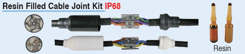

They said they couldn't get it running and showed me the little plug and socket thing they bought for it as cef told them it was water resistant but on looking it seems only splash proof or water resistant for 30 mins! they have I expect had it submerged in the fountain around a foot deep overall and it is fed in on white 1.5mm 6242Y T&E cable! the entry to plug and socket is stuffing glands. They say it worked around a week then someone saw smoke coming out the coupler between the plug / skt assembly and it keeps tripping the mcb! I have had a look separated the plug and it still trips the 6A mcb although there are many issues now uncovered on the property with electrics. I don't know why the pump has been fed outside in the base full of water with twin and cpc but I advised them this is not right and still on an mcb type b not great either! I take it fountains and pumps like this would usually be wired to / jointed before going anywhere near the fountain and water itself?
