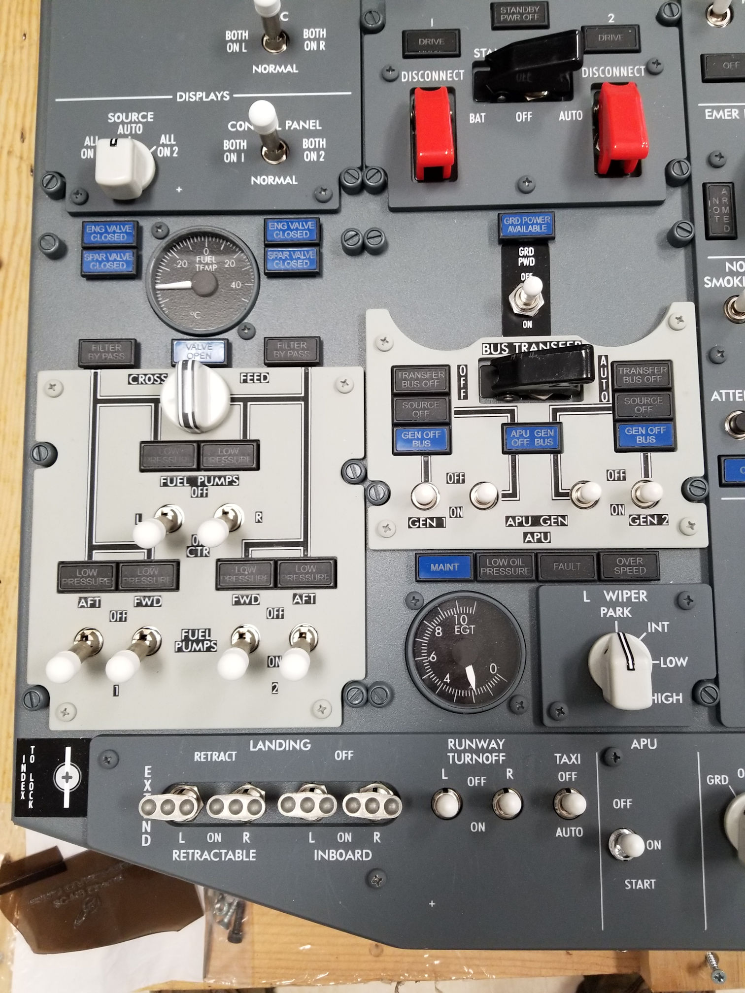

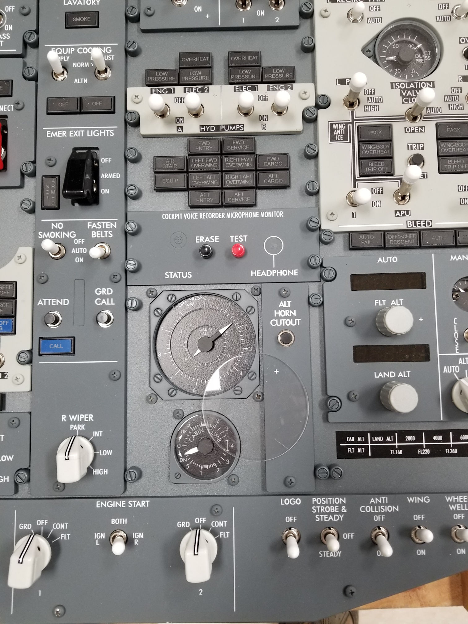

ive got a gaming device that has lots of switches, servos and backlighting in it. It’s powered by 5v for main power, 5v for servos and 12v for backlighting.
It all sits in a metal case.
Just recently I’ve had a strange problem when using it that when I touch certain switches or even if I touch the metal case then my USB joystick on my pc disconnects and then reconnects. I narrowed this down to potential electrical interference (as I had disconnected everything from the gaming panel to my pc) and put 4 ferrite beads on the usb cable from joystick to pc which stopped the disconnects of the usb device when using the overhead panel but only when I used 4 x 5mm ferrite beads. The disconnects did reduce if I had 3 ferrite beads on but 4 seem to stop it all together.
This now leaves me with an overhead panel that may have a short circuit and a live case?.
My question is how do I best go about checking this with my multi meter.
I was advised to power the unit then plug one probe of the multi meter into a spare earth socket on a plug socket and then using the other probe touch the gaming metal outer panel (on a bare metal section - screw hole).
I tried this when it’s powered and got the following results when setting the multi meter to DC 2v. There was a lot of fluctuations and the range is listed below:-

Hi - if I understand your home made device correctly, you've a metal box with connection to mains power? This box needs to be earthed, as a matter of your personal safety. Can you take a pic of the equipment ? Edit - beaten by @Spoon again :)
It’s not home made.

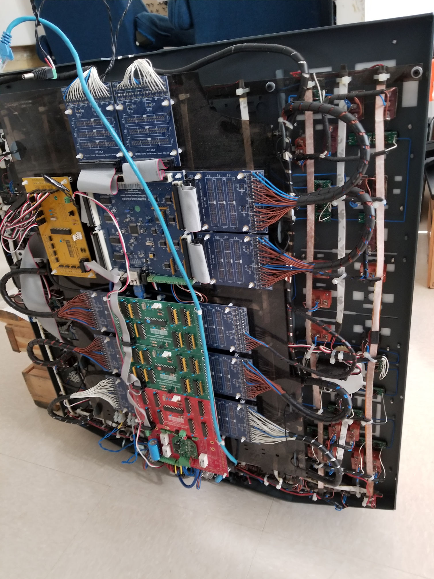

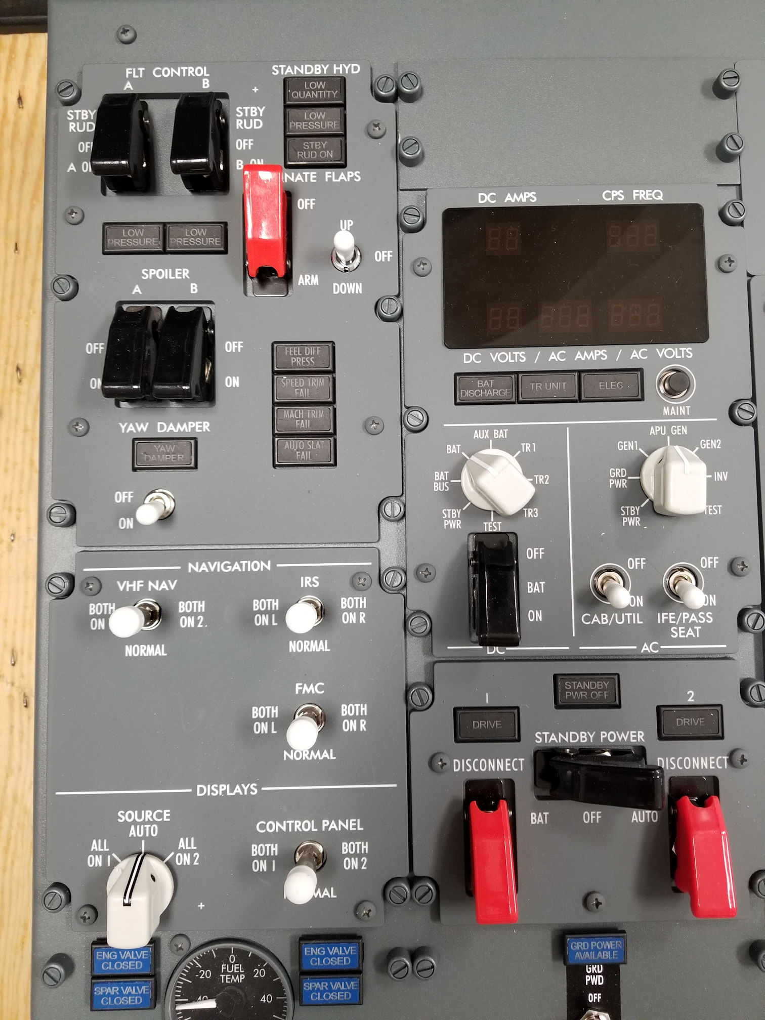

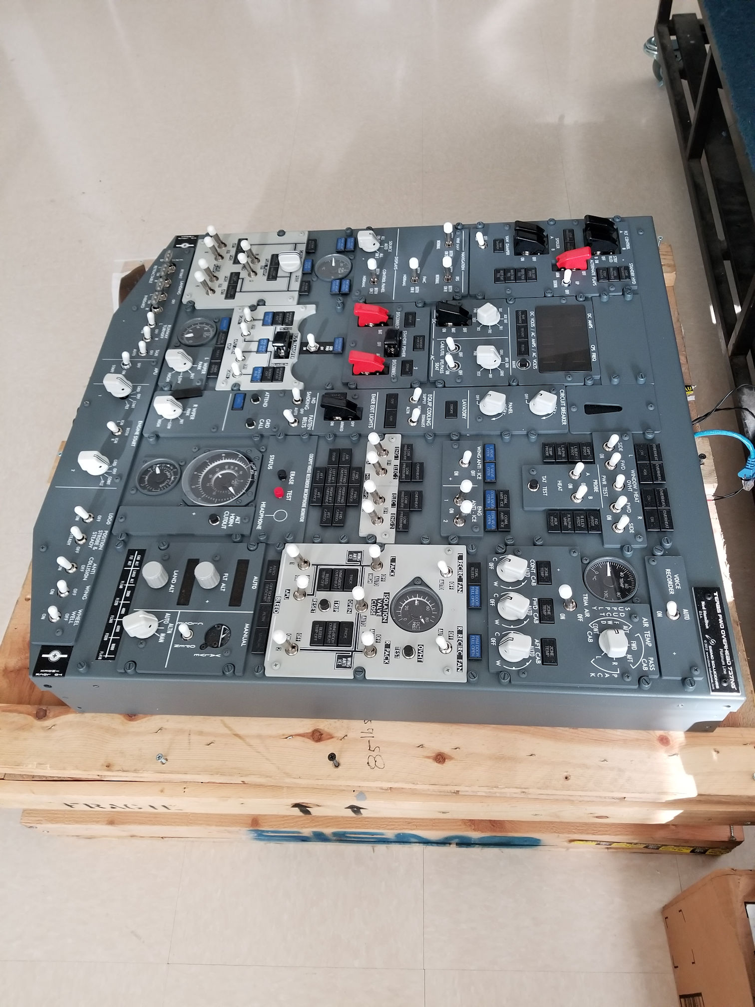

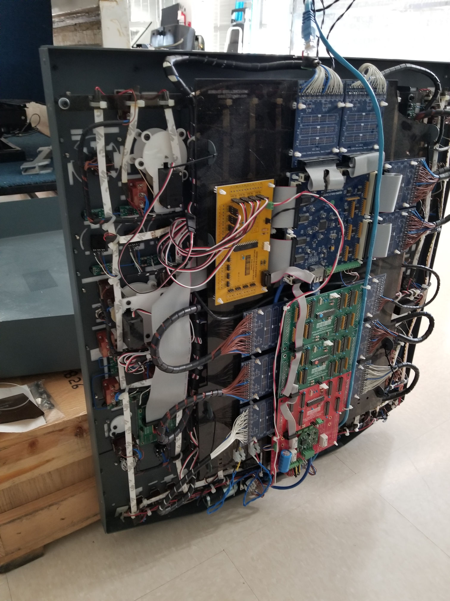

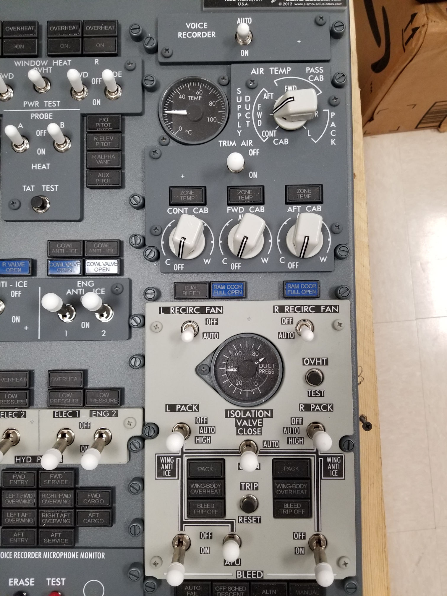

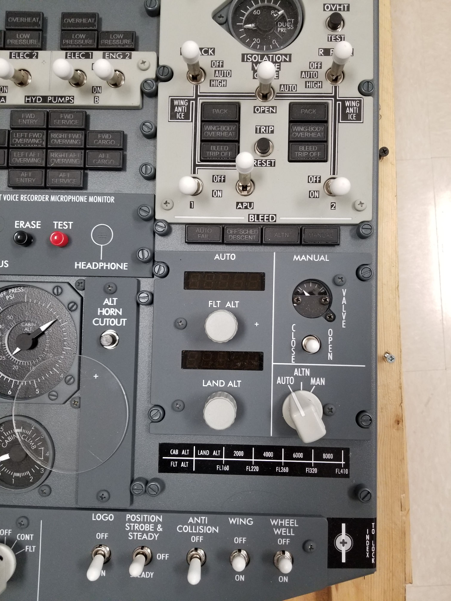

Photos of the unit are attached.
It has 3 x jack plugs therefore I assume they are not earthed being jack plugs however the kettle leads that plug in to the transformer have and earth pin.
Should I run a wire from the case to earth?
I’m not even sure there is a fault with it. It was purely the fact I had to put ferrite beads on to a joystick usb to stop it interfereing with the joystick. And then when I did a voltage test on the case and a probe on earth that I got readings.
