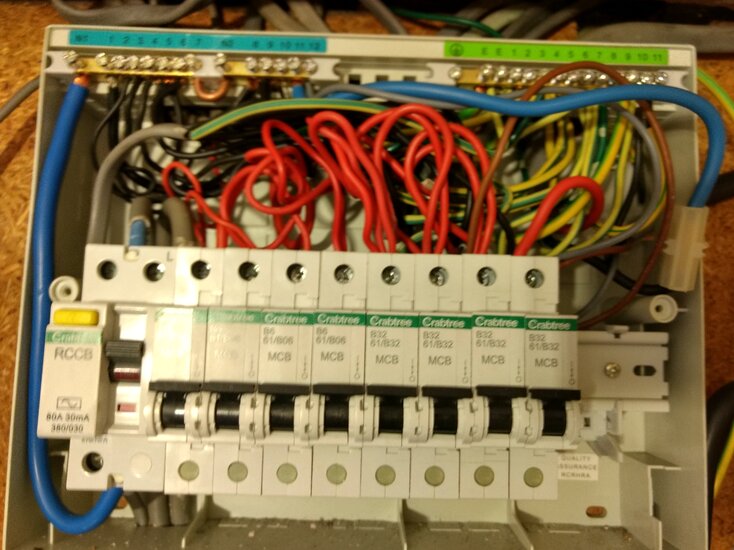

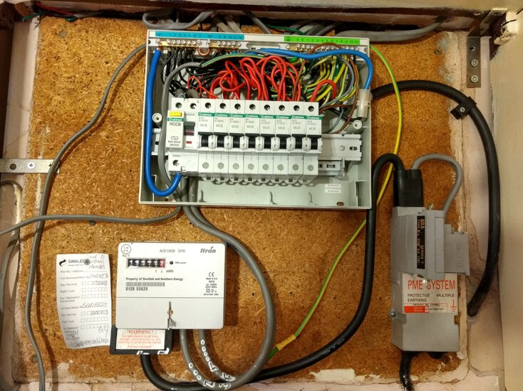

IMG_20180630_143815517_HDR.jpg Apologies for the late reply, been camping for a couple of weeks in Devon with my daughter's.......as you can see the board has 2 spare ways. The armour cable core wires are the brown ( connected to a house socket MCB!) and the grey you can see connected with the rest of the neutrals. ....so how can I get my garage CU to work without tripping. It's got 2 ways on it a radial light circuit with 5 bayonets & a ring with 4 socket's, I've checked and rechecked the connections, no obvious fault .....any more advice be greatly appreciated, thanks, Dave
that boards looks well overcrowded. time for an upgrade to either a hi-integrity dual RCD board, or RCBOs and 1 or 2 non-RCD ways. think a 15 or 16 way would be about right. ( thats usable ways, excluding main switch and RCDs).
Thanks for the photos, interesting to see the swa isn't earthed by the looks on the armour.
You would need that and also some kind of protection to disconnect the swa in case of a fault. Eg separate RCD
