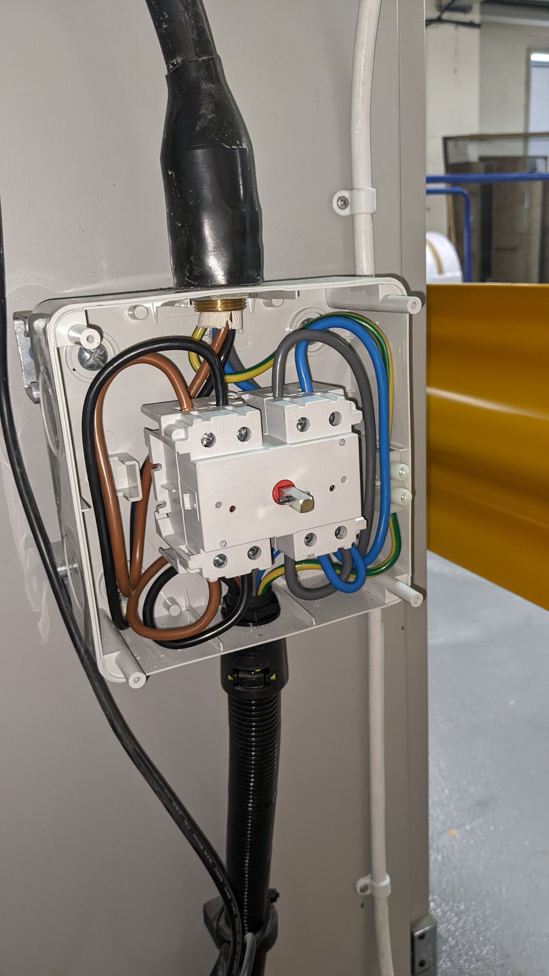

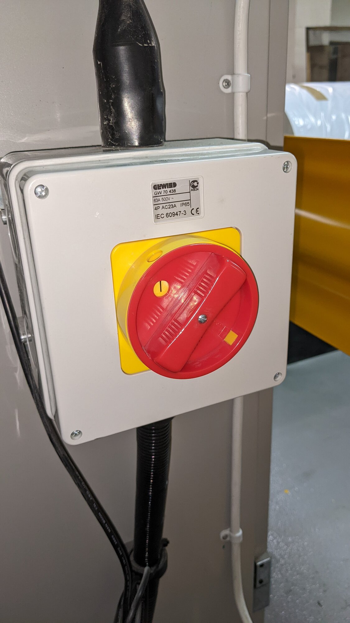

Hi, I'm currently testing a factory and having difficulty removing an isolator cover to test a circuit. Usually, it's just a case of switching off and removing screws however the cover doesn't seem to want to come off as if the mechanism is stuck but it definitely is working as you get a real positive lock and before I break it or change it needlessly is there something silly I'm over looking lol
Yes remove those two screws and it will come apart, the rest inside should stay put if the two plastic fixing tabs top and bottom on the rotary part haven't broken off and they do! Also you will find that the terminal screws are ridiculously small and fragile.

Looking at it, the four corner screws would come out, the lid would come off, but the yellow part would stay as it’s mounted on a din rail
You have to take it totally apart middle grub screw on red rotor then two internals on yellow done loads of theese whilst connecting cabin supplies
Perfect thanks mate knew it would be something simple never fitted these and normally you just switch it off take the 4 cover screws off

Anyway, working on those isolators is nearly always an unpleasant experience and before touching one I try to have a spare unit handy. I concur that you only have to sneeze near the terminal screws and they snap.
Probably breaks some H & S rules, but, with the addition of a couple of short self tapping screws, it's possible to reassemble these switches so that the cover can be removed without all the rotary part dismantling
