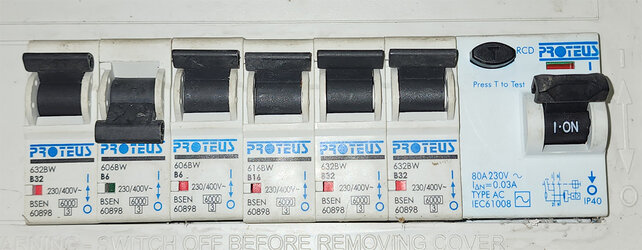

Hi all, so just moved into a new property, the light fitting/rose was removed from the living room, nothing looks to be shorting (But there is a single neutral with no connector block?) but the breaker trips straight away. There are 4 fittings on this floor, none with bulbs in, none with any sign of issues with the fittings.
So is there an easy way to diagnose where the short is? (If that's what it is)
Thanks for any help here ;)
