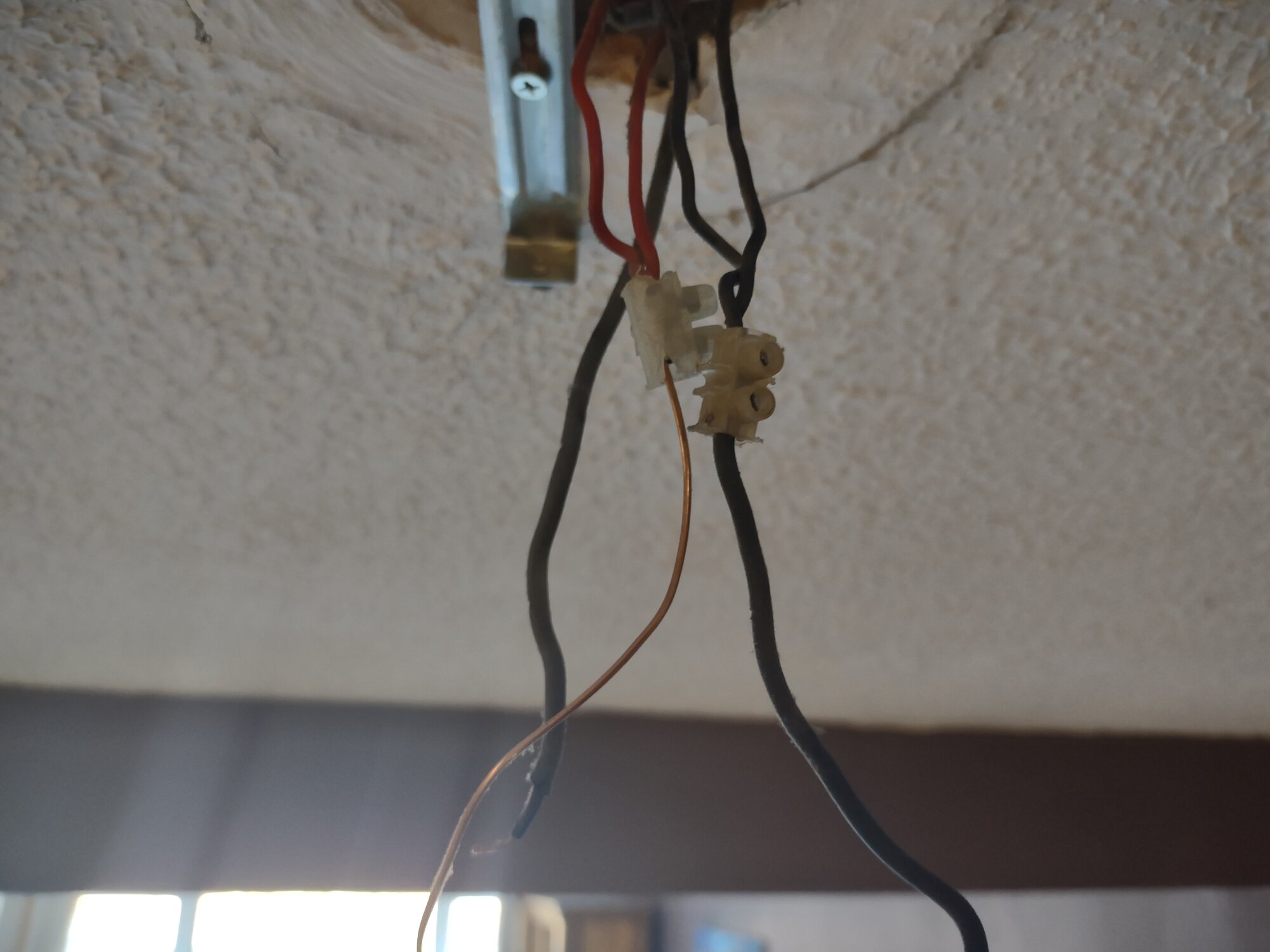

Yesterday I got complacent, lazy and careless.
All the job was was changing two light fittings. I'm sure I'm not the only one, even if others don't care to admit it, that just checks the lights themselves are off at the switch. A very bad habit, and, I learned the hard way.
See photo attached. I have no ideas how they managed it. But I got a massive belt and a real scare.
Lesson learned!
Regards all.
Dave
So was the whole fitting live when the switch was on? Or was that bare copper sleeved previously?
Someone needs to invent gloves or something with a built in voltage detector. So when you get near to touching live, it beeps or screams at you to make you stop.
The earth fly lead is attached to the PL loop.
No sheathing, bare copper.
Ouch.
Jus glad I was only 2 steps up the ladder and landed on my feet. Do have two tiny burns.
