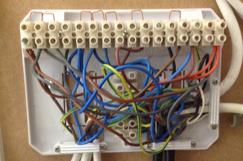

just love those bare links at the top. waiting to give the unwary a bite.
Wow are those un-insulated links for real?
Yep.
Owner swears it was done by a proper Spark and wouldn't blame Mr Plumber (I admit that I did try to get him over that line). Even more badness - the single retaining screw for the wiring centre cover was missing - so half asleep first thing I opened the cupboard, bumped the box and the cover fell off, revealing all its naked glory. :eek: . They've got brooms and stuff in there and it's just luck no-ones been hurt. It also has a 3kW immersion running on 1mm flex from a 13A fcu. It was on when I got there (don't ask me why... ) and the cable and fcu were toasty. Freed up the CH valve, took fuse from immersion, secured the wiring centre top and beat a hasty retreat for today. I'll go back later in the week and make it presentable.
