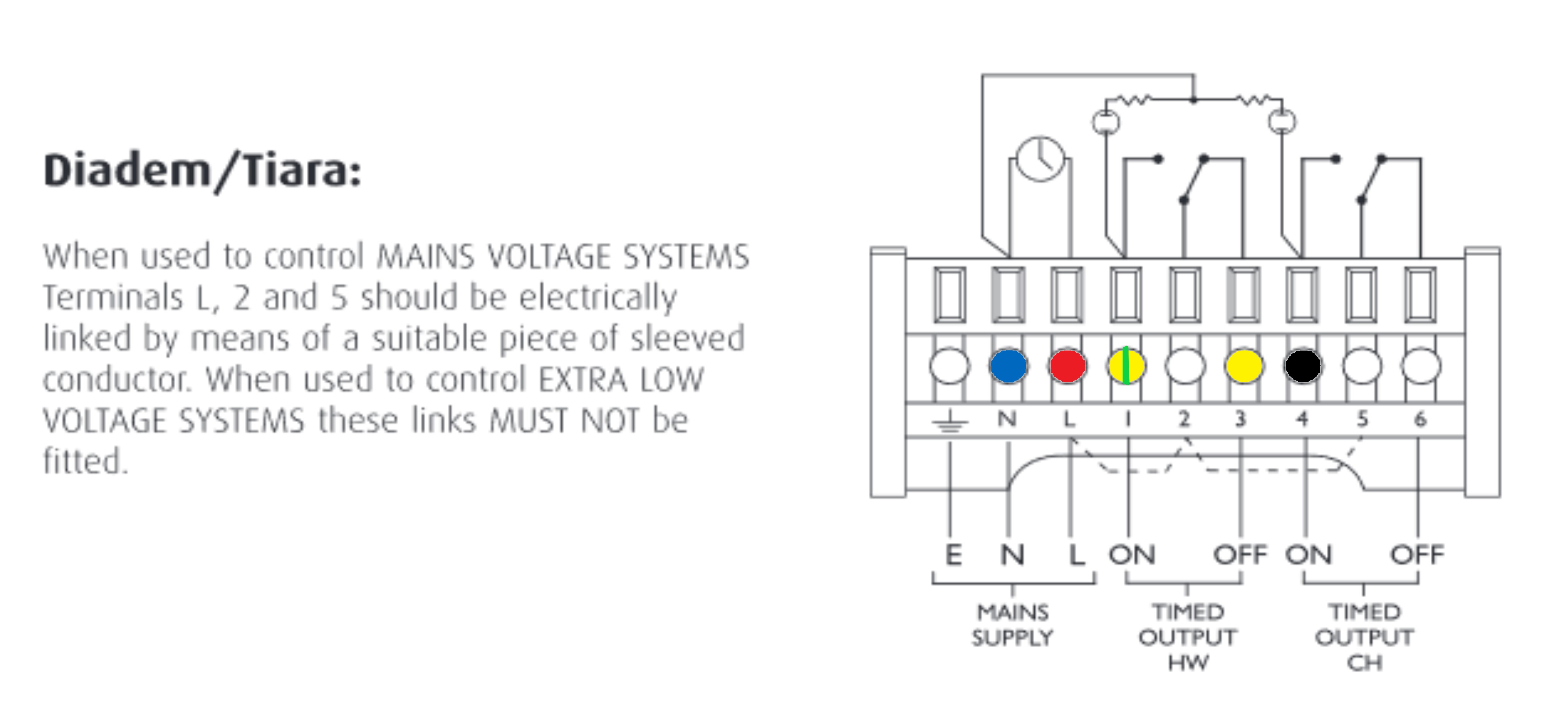

I'm trying to replace an old Landys and Gyr RWB2 heating & hot water timer with a Horstmann 425 Tiara.
I'm just a bit perplexed as to the wiring - I've looked and the wiring diagram for the old timer and tried to convert it to the new 'tiara' timer.
But it looks totally wrong.
Can someone have a look and see if they can spot what I've done wrong? Heating timers are not my forte.

I see the cpchas been used as a control conductor, not a good idea.
You would be better advised to get an Electrician in to sort the cable out and connect the controller up for you, advising someone via email and pictures is not a good idea really.
