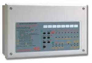

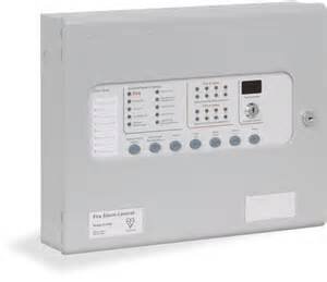

Firstly what make of panel is being used, and is the zone and sounder circuits seperate or wired on the same zone cable
The panel seems to just be some generic thing - no manufacturer written on or in it. No manuals, nothing.
Circuit has both detectors and sounders on it... the final item in the circuit is a sounder with like a resistor across + and -

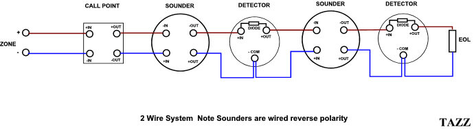

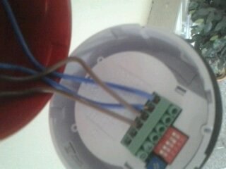

Ok can only guess you have 2 wire or a Sav wire systems and the sirens are wired incorrectley, fuses are usually 500mA or 1A 20mm glas quick blow, see 2 diagrams for correct wiring
Thanks! Yes looks like the 2 wire one... but it looks like it's wired right. I tried putting the last bell in 'normal' polartity and that set the sounder off, without blowing the fuse... put it back to reverse and it shuts up, but still blows the fuse when alarm set off (there is at least 1 other sounder in the zone)

Nah not like those, similar though. Got the two keys, lights for zones, faults, fire etc, small keyad with function buttons and numbers 1-4, that's about it. The most striking thing about it are these tiny square fuses inside.

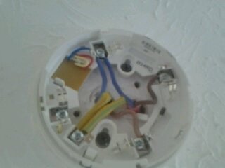

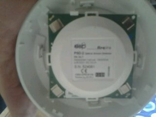

Ok its a sav wire system and your esp detectors will not work with this, You need Apollo sav bases and Apollo s65 detection, the sounders you have will be ok, This is why the fuses are blowing
Really? OK thanks very much for your help. Are you sure it is sav? The existing (circuit board) detectors have a common neutral but an 'in' and an 'out' on the positive side, is this right for sav?

Would like to make sure we get it right before buy more detectors which could be wrong, are the sirens part of the base or seperate. and is this the panel...otherwise suggest some photos tomorrow and we will then know what you have
That looks closer to what I have, but still not quite. I will try and get some photos today.
Yea the sirens are seperate from the detectors.
