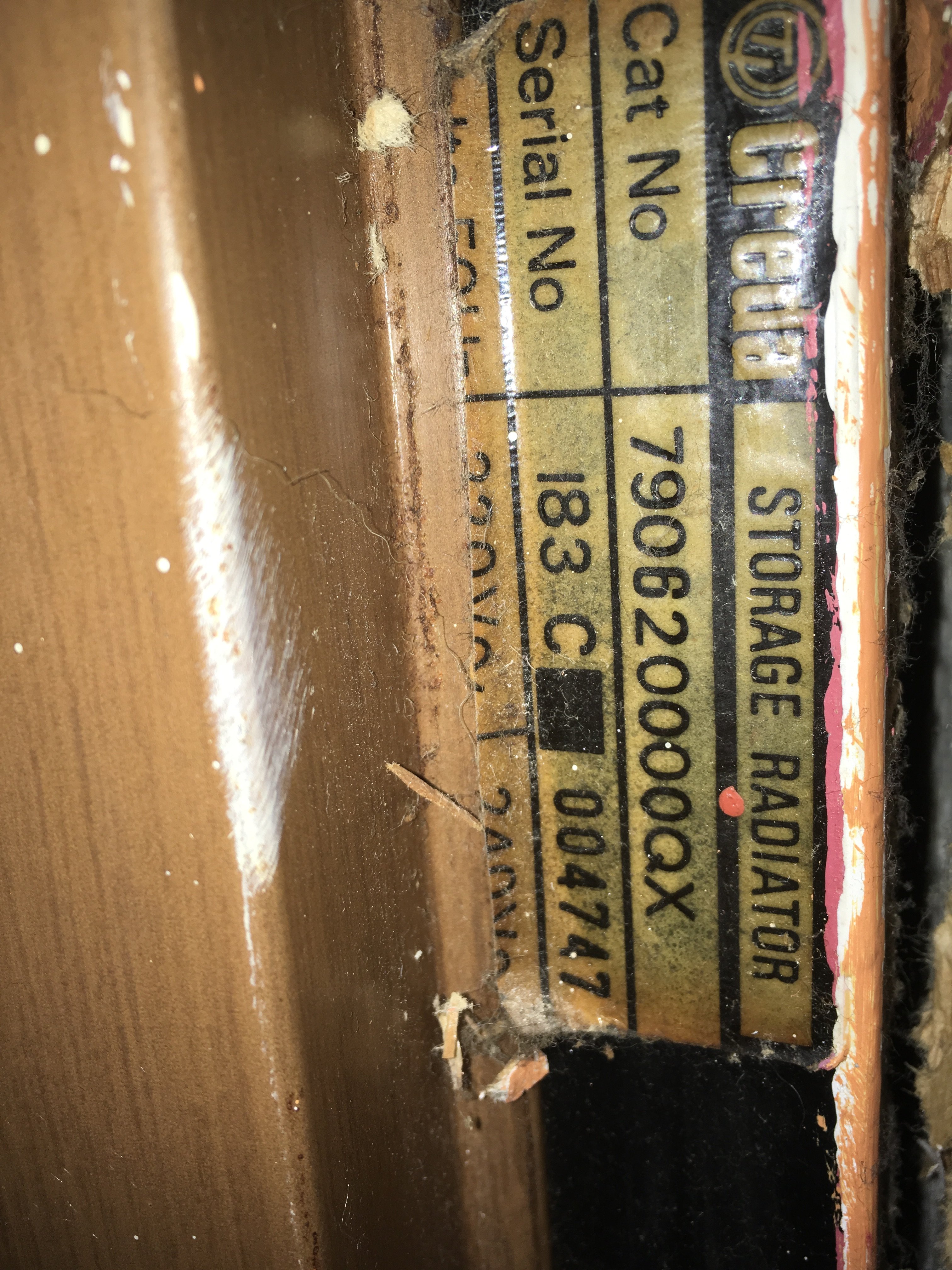

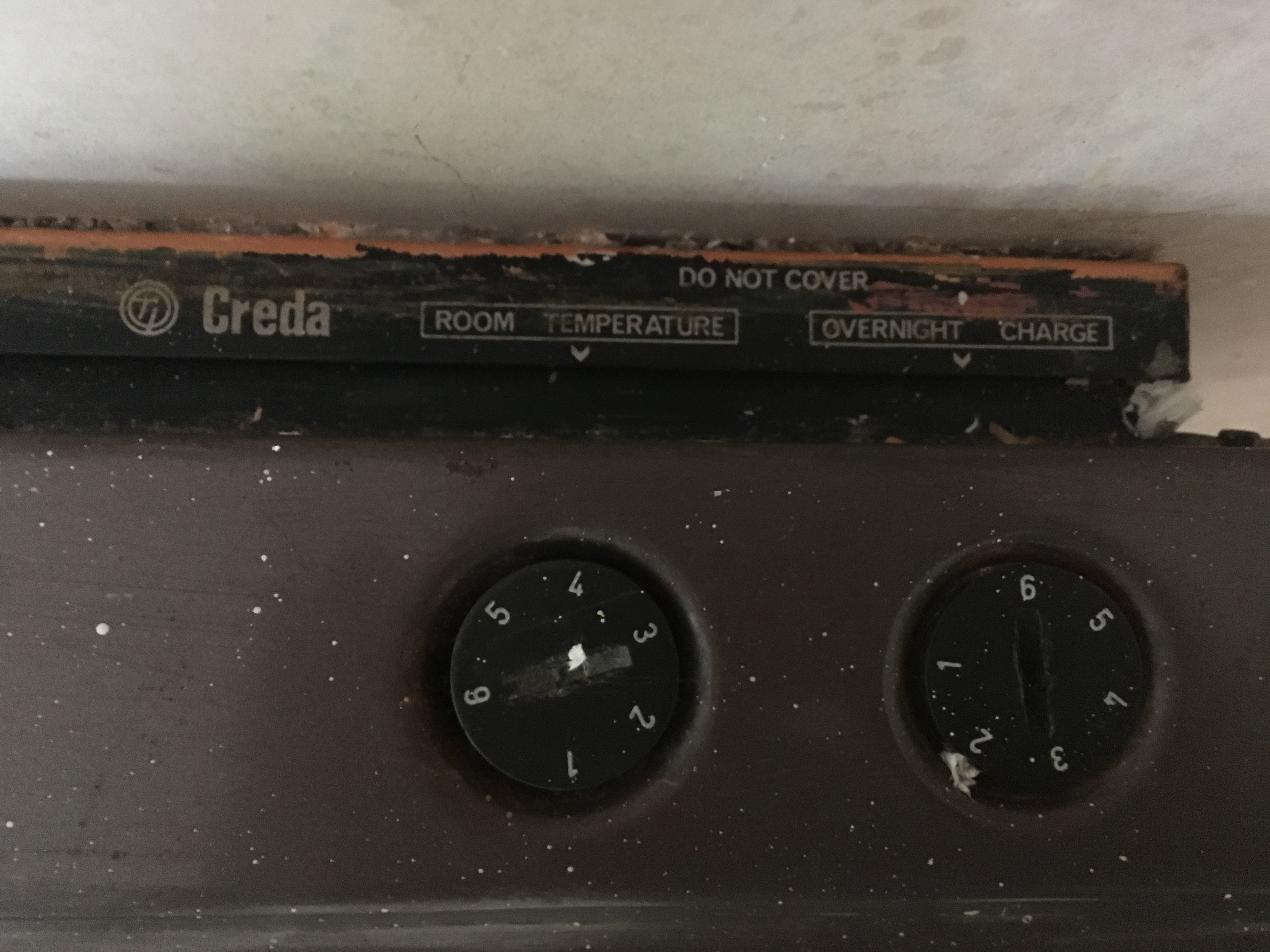

Hello I hope someone can help me with a similar problem. I have no idea what model or how old the storage heater is in the flat I just bought. It's creda, it has a sticker stating 'Creda Storage Radiator'
serial no. 183c 004747
Cat no. 7906 20000qx
But sadly there is no other info on it. I've hopefully attached 3 pictures to help. I found a list online of heaters containing asbestos but don't even know what mine is..
I'd like to update it but am a bit stuck without knowing much about this one. I'd really appreciate any responses
Many thanks
I think the model No. is 79062, Many Creda heaters have 5-digit model numbers beginning with 7. This probably makes it a TSR range heater from the early 80's which the list shows to be asbestos free. Please double-check this information if possible before assuming it is indeed asbestos free.
Thanks for the information. I've at least got a decade to go on and it sounds a bit more promising as the asbestos ones tend to be 70s I think. Wasn't it stopped in the early 80s? I appreciate your reply so soon esp with so little to go on..
