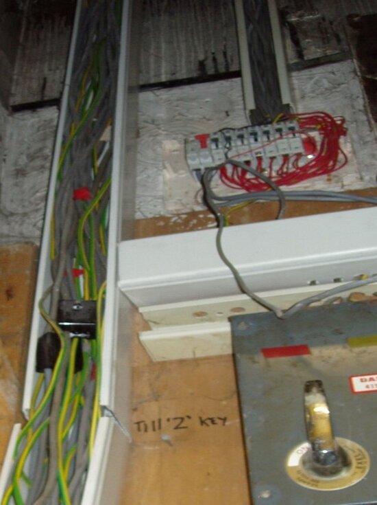

This is the way your DONT want to do it, cram all those 16mm cables off 80A landlords fuses into a bit of trunking and start running them up 4 storeys to 8 conveted flats throughout the building with everything run of electric (kitchen, heating & water) ..... and while you're at it put in a CU for the communal areas/fire alarms/emerg lites and dispense with the protection around it!
Picture quality not that good as the camera phone was shaking a bit at the time - I was just starting to get my first overall initial impressions before completing an EICR post the local council refusing to re-register the property.
Not my install I hasten to add but done by a reputable "electrical contractor" who pride themselves on 'time served' electricians!! (In fairness I think the consumer unit had been damaged after the install)

I wasn't even thinking of running 16mm I wanted to be sure that 25mm is big enough. Wow that install is on another level! I would like to book an yearly assesment on that one for a joke, I think 500£ would be worth seeing guys face! :)

Saw work like this on a farm, it was done by a Polish 'electrician'.
