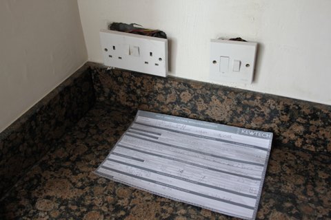

Hi there, I am Michelle and HT was helping me out as I've been pretty clueless on this forum.
Please let me explain that I'm not an electrician, but am a bit unhappy about what has happened in my kitchen. I had hoped to seek some advice and joined the forum as a result.
Ok, down to it.... I've just had a kitchen installed. The guy who did it said that he was Part P registered (no idea what that really means, but accepted it as being fit and proper to do the job). Aside from taking 3 weeks to do the job, he has signed off part of what he has done (but not all of it) on a certificate. I've posted the photos on facebook of the electrics (and other things) which is open to public access - my username is Michelle Baird. - sorry I digress, off on a personal crusade now.
The part P certificate I placed below the hanging-off-the-wall, live sockets and photographed as I think the world should see.
Is there a register of Part P certificated persons? I've looked on the Competent Person's List (better late than never eh??) but I can't find his name on there.
The cooker has been moved about 3m away from its original siting but he left the switch in situ in its old place ie 3m away from the cooker - not sure if that's ok?
I suppose what I am saying is that as the rest of the kitchen has been a bodge-up (although no-one is going to die from a poorly fitted kitchen), I am concerned now as to the safety of the electrics or if they're done right. Who do I go to to check his competence, if the job is done right, if it is safe?

I doubt very much he is a registered electrician, the certificate he has used is one you can buy over a counter at a wholesalers, it is not one from any part P scheme provider. Also this work is notifiable to your local authority, any registered electrician would of done this for you as part of the job, did you see this "electrician" with any test instruments? Any meters to test his work? Were you about when he wrote the certificate out?
All this to one side... This is not to say your kitchen electrics are unsafe and you are at any risk, 3m for a cooker isolator is too far in my opinion. Also has he left the sockets back thinking someone is about to tile the wall? Although this is no excuse for not screwing them back
Thank you for your comments Mr Mike, I appreciate your time. He did know that we weren't tiling as we asked him if he would sort the walls ready for painting (due to the upstands).
Thanks for the advice re the certification. so it basically means nothing? I wasn't there when he did the checks, he did it when I was at work.
He is a kitchen fitter first and foremost but claimed to be qualified as a plumber and Part P certified for electrics. Apparently been in the trade for 32 years......
Hi Michelle does he have a regestration number on his certificate or state Elecsa Napit NICEIC etc if you are not happy it could well be an idea to contact your local trading standards , you could always say where your from im sure one of the forum members may be able to pop round, High tower is a good guy
