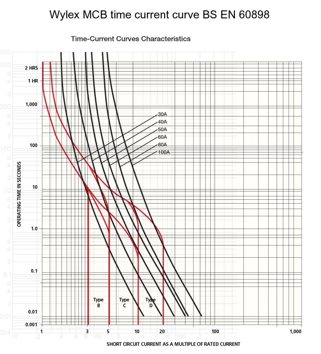

Even if you put a 32A type B circuit breaker (or DP RCBO since there is no RCD protection at the moment but you may fall foul of preventing innconvenience) in after the main fuse then there is no guarantee that the circuit breaker will trip before the fuse blows.
A type B 32A MCB will not necessarily discriminate from a 30A BS1361 fuse.
Even though I am by no means well versed in discrimination techniques. As a rough guide, although you would need to know the manufacturers data for both, the prearcing I²t of a BS1361 is about 1200 and the total I²t of a 32A type B MCB is about 31760 so well outside of discrimination on a complete discrimination level.
I have overlapped a couple of graphs (very approximately) for a BS1361 and a 32A MCB and there is some discrimination but nowhere near total.
