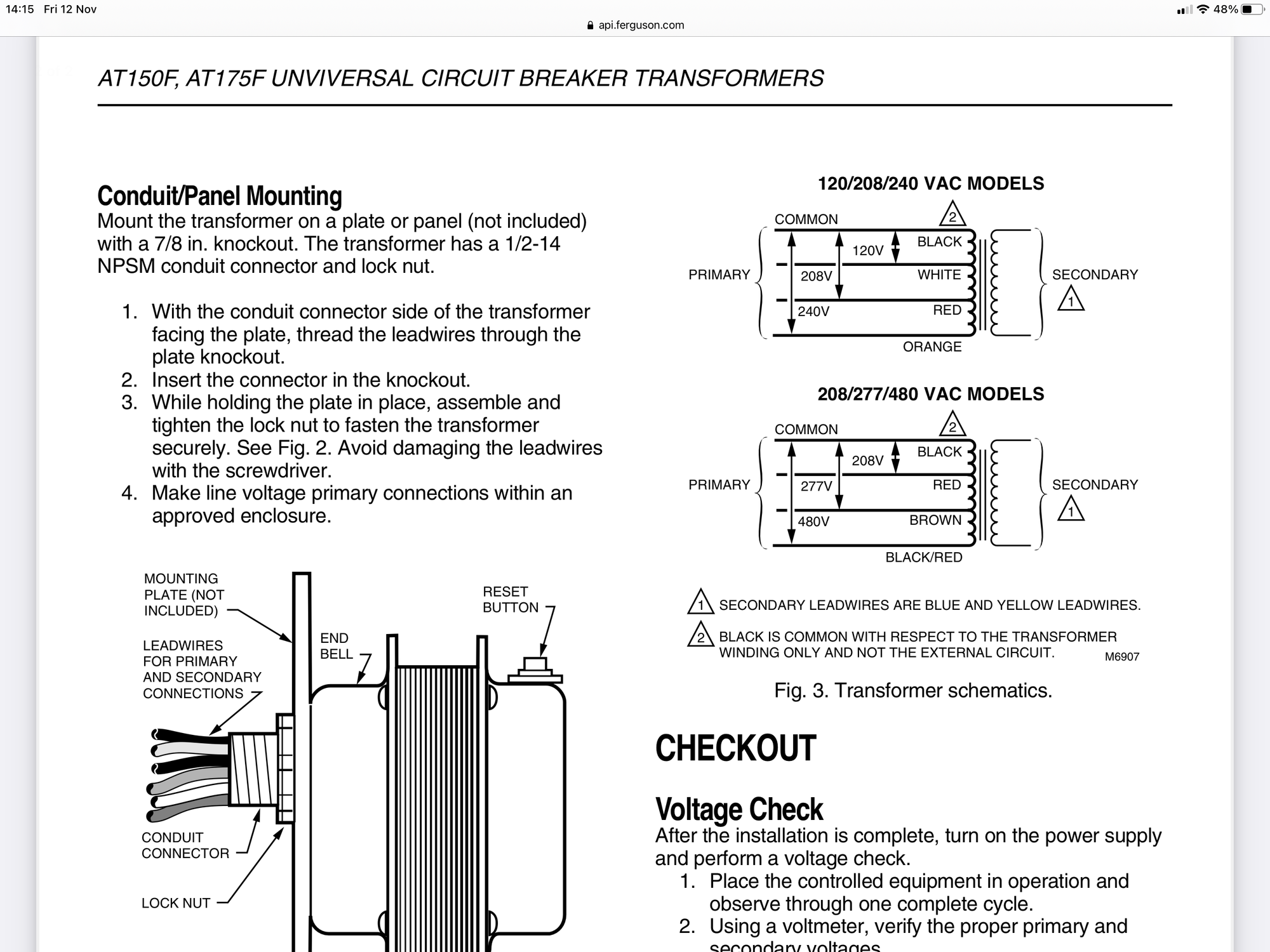

Hi, I'm replacing an old AT88A with the AT175F for my hydronic heating, which is connected to my 2-wire mercury t-stats and Honeywell V8043F zone valve motors (yellow leads). Wiring diagrams always show the "hot" red wire from the transformer going first to the t-stat, then white wire from t-stat to zone valve, then from zone valve back to "common" on the transformer. The two secondary wires on this transformer are Blue and Yellow, and the "common" on the Primary side is Black. The footnotes on the instructions say: "Black is common with respect to the transformer winding only and not the external circuit".
I need some clarification on how this should be wired:
(1) On the Primary side, the Black lead should be connected to Line White (Neutral) and the Red lead should be connected to the Line Hot (Black) (120V). Is this correct, or does it matter?
(2) On the Secondary side, which of the Blue/Yellow leads should I consider as the "red/hot" wire shown in the diagrams for wiring up to t-stat? And, does it even matter?
(3) If if doesn't matter in #2 above, and I want to use this setup with a smart t-stat that requires a third C-wire, does it THEN matter which is connected to R/Rh on the t-stat?

You have the right idea, but the red transformer wire is the 208V tap according to the data sheet. The white transformer wire is the 120V tap. Use whichever corresponds to your supply voltage.
I don't believe it actually matters which way round.
The unused ones obviously need to be insulated as they will be live!
It doesn't matter. The secondary is 'floating'

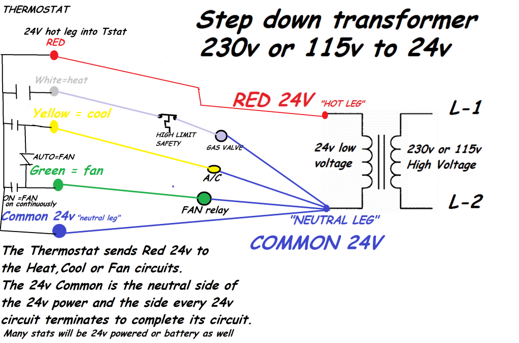

That's what I would assume as well, but I keep seeing wiring diagrams like this that indicate that one lead is "hot" and one is "common", and the "hot" side always goes to the T-stat, white from T-stat to Zone motor, and then back to the "Common".

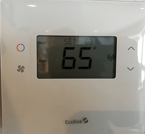

And, as for #3, what I am trying to do is install a smart thermostat that requires a C wire (for continuous power) to replace my old 2-wire mercury switch t-stats (which just acted as a 2 wire switch). I have a third wire, so I can use it as C, and I assume that I can connect it to the transformer where the return from the Zone valve is. This would basically give me a circuit from one side of the transformer to the R on the T-stat and a return from the T-stat via C to the OTHER side of the transformer, which would provide 24Vac for operation. That's my end goal.
I appreciate your previous response and help provided.
I'm afraid I'm not clear whether the smart stat requires continuous mains (120v) power, or if it requires 24v?
If mains, I would hope it has its switching circuit(s) isolated from mains, so the 24v secondary control side can remain not connected to mains voltage, which would seem safer.
Could you point me to technical details for the smart stat?

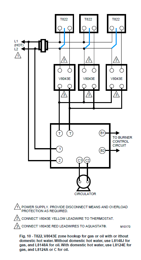

Update - I see the Honeywell valve manual has some example wiring diagrams that are vaguely similar to what you describe, eg pages 5 and 6 etc.
So I think what you are proposing is OK. Just be careful to treat all your wiring as if it is at mains voltage!
Again from the info I see, it won't matter which way round the transformer secondary leads are connected.

It is typical to see a low voltage ac transformer with a + and -. All this means is the - or neutral is terminated to ground at the transformer inside the unit. It sounds like your new thermostat requires a constant 24v, just like you mentioned this can easily be done with a 3 wire. One wire on the R in the unit. One wire on the heat(W). One wire on the common(c) or you can simply land this wire on the grounded side of the 24v transformer. You will notice that between common and ground you have continuity.
That's interesting. There was no mention of that in the data sheet of the transformer, so I'd assumed the secondary was floating. Would be worth a check.
It won't be mentioned in the data sheet for the transformer, and can be used without grounding one side. It usually only grounded inside of a unit like a furnace. This is were the terminology for "neutral" or - comes from inside of an AC circuit. In your scenario the secondary (24v)may not be grounded.

I think I now have what I need, but I'm waiting on a response from the company because I'm not sure if the tstat is looking for 24VAC power across R-C or W-C. I assume R-C, but they labeled 'R' in their manual as 24VAC RETURN. It probably doesn't matter, but one of the two (R or W) is connected directly to one side of the transformer, and the other is connected to the Zone Valve motor (which I believe is typically W).
Now, in the case of R being connected to the transformer, and W to the Zone Valve, my thinking is that I would connect my C from the tstat to the transformer side of the Zone Valve motor lead (the OTHER yellow lead). As I proposed before, that would give me a continuous flow of 24VAC whether the tstat was calling for heat or not. I'm just waiting to hear which tstat terminal needs to go directly to the transformer. If any of that sounds off, please let me know.
