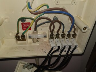

Had an old model horstman which died on me so I replace it with the newer model.
Can't seem to get it to heat up anything, boost light won't light up either?
1x 18inch vertical immersion ( tested element came back 20ohm)
Could it be the stat that's not working preventing this? My screwdriver lights up saying that power is being supplied to all units. Any help on this?

Could you post me a picture of how you have wired the black leads to the back of the H7? Mark or label each black wire so I can work out which one is connected to the terminals bottom right.
Remember to turn all the electricity off before you touch anything.
