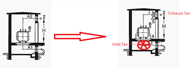

I have a transformer with ONAN cooling (natural ventilation like figure) and 2000 kVA that works always near full capacity, in summer it over heats above the limit. to improve the cooling and prevent reaching the oil temperature limit. I decided to place an exhaust fan and an inlet fan like exactly the figure. the exhaust fans are usually used but I want to know if it is ok to place a fun under the transformer to blow air directly to the radiator knowing that it was originally designed as ONAN and not ONAF.

Looking at the drawing you attached it looks like a corrugated tank and not radiators? Is that a conservator tank on the top? Hopefully if it is (not really clear in that picture) it'll have a bucholz between to con tank and body so it should trip if the level gets low so you can rule out low oil levels. If it's not got a con tank and it's a sealed unit then be very careful. I've had to deal with corrugated tank transformers that have buckled through over heating. You say you have the Tx maintained. What sort of DGA results are you getting? The only real fix for what you have is to either reduce the load of fit a higher rated transformer with external radiators and WTI controlled fans.

Looking at that picture it's not a corrugated tank, it has rads and it has a con tank which should allow it to breathe so ignore my comment about the tank buckling. I can't see any reason why cooling fans can't be fitted. Only comment I would make is how they are going to be operated as I doubt if it's got a WTI with fan on/off contacts. I would recommend a DGA test just to confirm everything is okay with the oil. Can also show up any faults that may be on their way. What make is the Tx?

Did not appreciate this was an indoor installation. Don't suppose you can move significant air into the room and out say with some wall plate fans exhausting with some inlet grills to let fresh air in ?
That would be my first choice for cooling if the room temp is significantly above outside ambient. You can create a room temp alarm pretty easy to link to your manned control room or something similar.
I would agree that cooling the room should help. Is it possible to fit high and low level vents and let the heat from the transformer circulate the air via convection? If you go down the route of fans you can either use a room stat or a better solution would be to fit an oil stat. The oil stat would be fitted in the pocket you have on top of the tank. Fill the pocket with oil and insert the stat, heat from the transformer oil will conduct through to the oil in the pocket which will then indicate the temperature of the transformer oil albeit with a slight delay.

Hi plugsandsparks
I followed a guide to chose the correct exhaust fans ( power and flow for the amount of heat generated)
and I will place an other fan in the inlet under the transformer or somewhere else to help)
Hi R-fur
I will follow your idea to measure the oil temp and room temp and I'm using a fan in the inlets under the transformer and an exhaust on the top of the wall.
