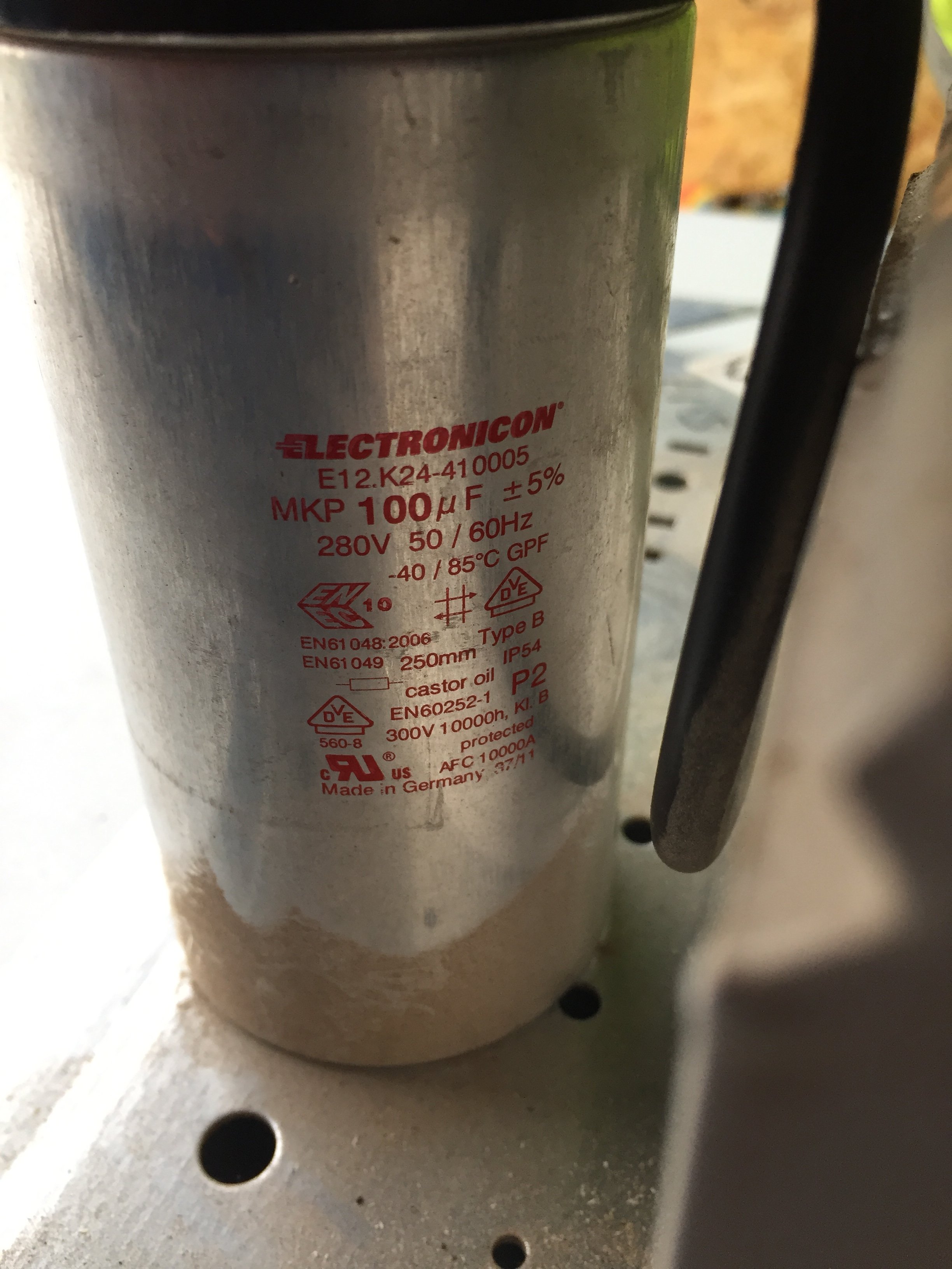

@Lucien Nunes ok that all makes sense I have attached a picture of the gear tray with the capacitor. Would the floodlight not require the capacitor to work or find the current goes through the roof with out it?

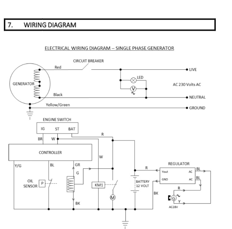

One thing I noticed on the Hyundai is it is split load.
Live - earth = 115v
neutral - earth = 115v
live - neutral = 230v
that’s something I wasn’t expecting from this generator. Would this be having any impact? I have attached the wire diagram for the Hyundai also.
The kubuta is more what I expected
live - earth = 240v
neural - earth = 0v
live - neutral = 240v

The fitting will work without the capacitor. Its supply current will increase to the same as the lamp current, 9-10A or so, harmonics may circulate with the other fittings and it may radiate increased amounts of electrical interference, so there are cons to this approach too. However you might be able to prove that with the cap disconnected in maybe just one fitting the output becomes stable, which at least pinpoints the cause. FWIW 100μF produces 1.6kVAR at 230V 50Hz, 7A flows through the capacitor.
The split-phase output should have no effect on the circuit behaviour however it does require double-pole fusing. If any connected circuits have only SP MCBs (&/or switching) or it is used to supply appliances with BS1363 plugs, they are unprotected in L2 (presently masquerading as a neutral). The N-E link in the generator might be reconnectable to one end of the winding. Consult the MIs.

@Lucien Nunes our next test is to try it with a capacitor removed from the gear tray. We realised that issue last night and currently installing double pole mcbs and twin fuse cut outs at the base of the poles as I type this. We did contact Hyundai to see if we can link N + E but got no response
So testing today..removing one of the capacitors from the gear trays has settled out the voltage issue
Many many thanks for the information and help. Hopefully this is the fault sorted out. We have a few modifications still to do but all is looking ok just
