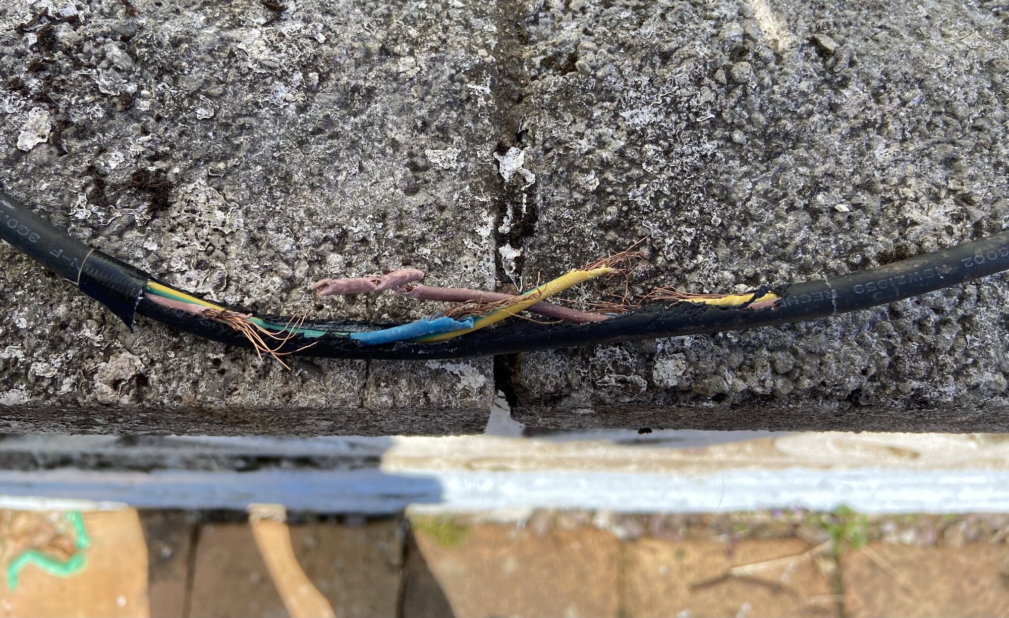

So there I am up an aluminium step ladder with padded feet. And I'm helping my son's best friend to put insulation in his loft whilst pulling the electrical cables up above it.
A 1.5mm t/e light switch cable, (2 metres / 78") in length went over to a small cupboard bayonet fitting, I could reach all of this from the top of the stepladder. This had a switch inside the cupboard which had looped over from the live supply on lounge adjacent wall switch, the cupboard was never turned on by anybody because the light in the hallway lit the whole thing up anyway. (It's a first floor apartment flat thing above shops, 10 years old)
But I had turned it on for no reason whatsoever and didn't realise I had livened it up .

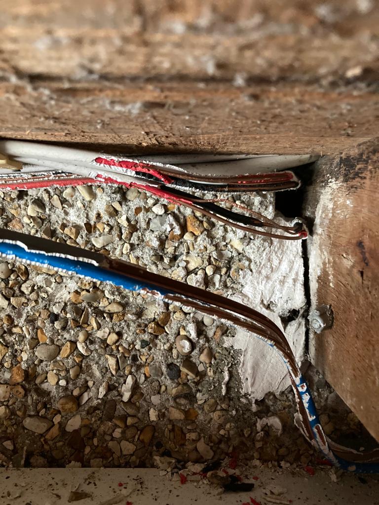

As I put my hand under the existing fibre glass (which had all been plonked on top of everything (junction boxs, led lights, cooker supply, ets etc!
I had the biggest electric shock I have ever had to date.
And as normal the RCD never tripped, and the place is supposedly checked out once a year as stickers suggest on consumer unit. All dated and only 10 years old.
But the cable had been eaten through completely (500 mm or 19'' 11⁄16in of it) was completely bare.
Why would they eat this with no deposits of cable anywhere, or is it nesting material. Or is it something to do with the bare copper?
Can anybody shine any light on this please?

No chewed up bits of anything,
All 3 strands of copper completely bare over 500mm of cable. You see some odd bits of /blue/brown outer sleeving but you have to look closely.
I'm now starting to wonder if it's something to do with being directly above Tesco's.
Found some traps out the back.
I'm sure PVC cable attracts them seen this a few times where cables have been totally stripped one was an outbuilding where nearly all the cable had been stripped of the PVC sheath
I'm trying to find some of these cable stripping mice for my scrap cable bin would save a lot of time and effort
I see it quite often where entire lengths have been stripped perfectly by rodents and are completely bare and in exactly the place they were before they had no insulation, they really do have some skills and 9 times out of ten they don't end up as a charred offering somehow either!

That is severe rodent damage, the little buggers love PVC, am surprised the little git is not hanging on the cable fried the way LNE are exposed.
Get pest control in before repairing/ replacing the cable.
