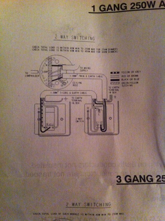

Hello!
I just bought a 1 gang 2 way 400W push dimmer.
I thought that would be dead simple to wire but it is not working.
I really don't understand how I could get it wrong!
I uploaded a photo of the instructions and a photo of what I've done.
What did I miss?
I checked that the bulb was a dimmable one.
What does total load mean?
Thank you in advance!

think you have only a 1 way wiring arrangement. is there 2 switches for the light or just 1? what concerns me more is that i can't see a cpc( earth wire) in the pic. as it's a metal faceplate, you need this for safety. i can also see what appears to be a lot of exposed bare copper conductors, in the terminals. i strongly suggest getting a local electrician to advise.

There is only 1 switch for the light.
I guess I just bought the wrong dimmer.
Yep, I read about the importance of the earth with a metal plate.
I understand your concern as a professional but I still want to do it myself.
Thank you very much for your reply!
Alex
then you must fit a plastic switch. the red to comm or C, and the black to L1. make sure the copper is cut back so that none is outside the terminal. obviously, isolate the supply before doing anything.

Dimmer switches usually have a symbol of an arrow with a line through instead of a 'com' or 'c'
Total load...
This is the maximum power the dimmer switch can handle. So if you have 4x 50w halogen downlights in the room that are operated by that switch the load in use is 200w.
