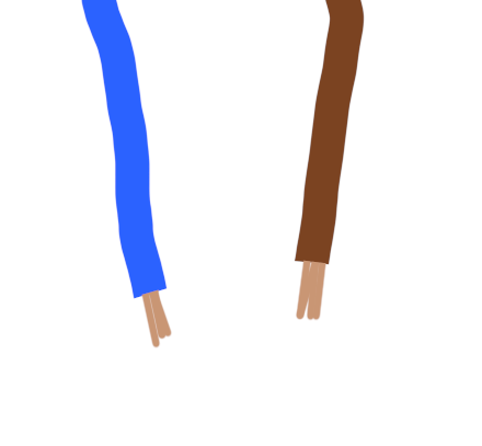

I am using it to connect a simple live and neutral wire connection (see excellent illustration below) this is all taking place inside an audio effects unit, the switch simply needs to connect the live to the neutral to turn the unit on - the live wire is carrying 240v (well my multimeter says 244v, but I assume that's 240v) . . .
Here's my issue, depending on which terminals I use, I can get the switch to turn the built in light on and off . . . or turn the power to the unit on and off (connect live and neutral) . . . but not both at the same time . . . . connecting live to the centre terminal and neutral to one of the outside terminals lights up the switch (but doesn't power the unit), connecting live to the centre terminal again and neutral to the opposite outside terminal powers up the unit . . . but no light.

You are not going to be able to switch the unit on by only having a live and neutral at the switch. The neutral only serves to supply the neon indicator, for the switch to function it will require a live in and a live out so three wires.
What he said ^^^^^. It's a single pole switch. Do you actually need to switch the neutral?
There are double pole versions, but I don't think you will need one.

I've probably not explained myself very well . . . I am able to switch the unit on - ('unit' = device this switch is controlling) - if I connect the live and neutral in the correct way . . . hold on, time for another of my excellent high quality illustrations . . .

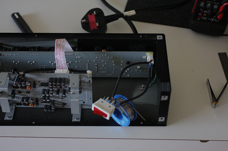

Here are a couple of snaps . . . not sure if this makes it any clearer.
Obviously the face plate and lid is taken off the unit, but basically the power switch would be on the front - poking through the face plate.
(don't worry I am not connecting this to the mains like this, with the wires just dangling close to the chassis, this is just to take the photos)
No, won't work like that unfortunately. As I say, it's possible, but not with just 2 wires.

what i can't grasp from the pictures in post#15 is that the socket on the PCB appears to be a L and N input, so connecting a switch across then will do nothing.
