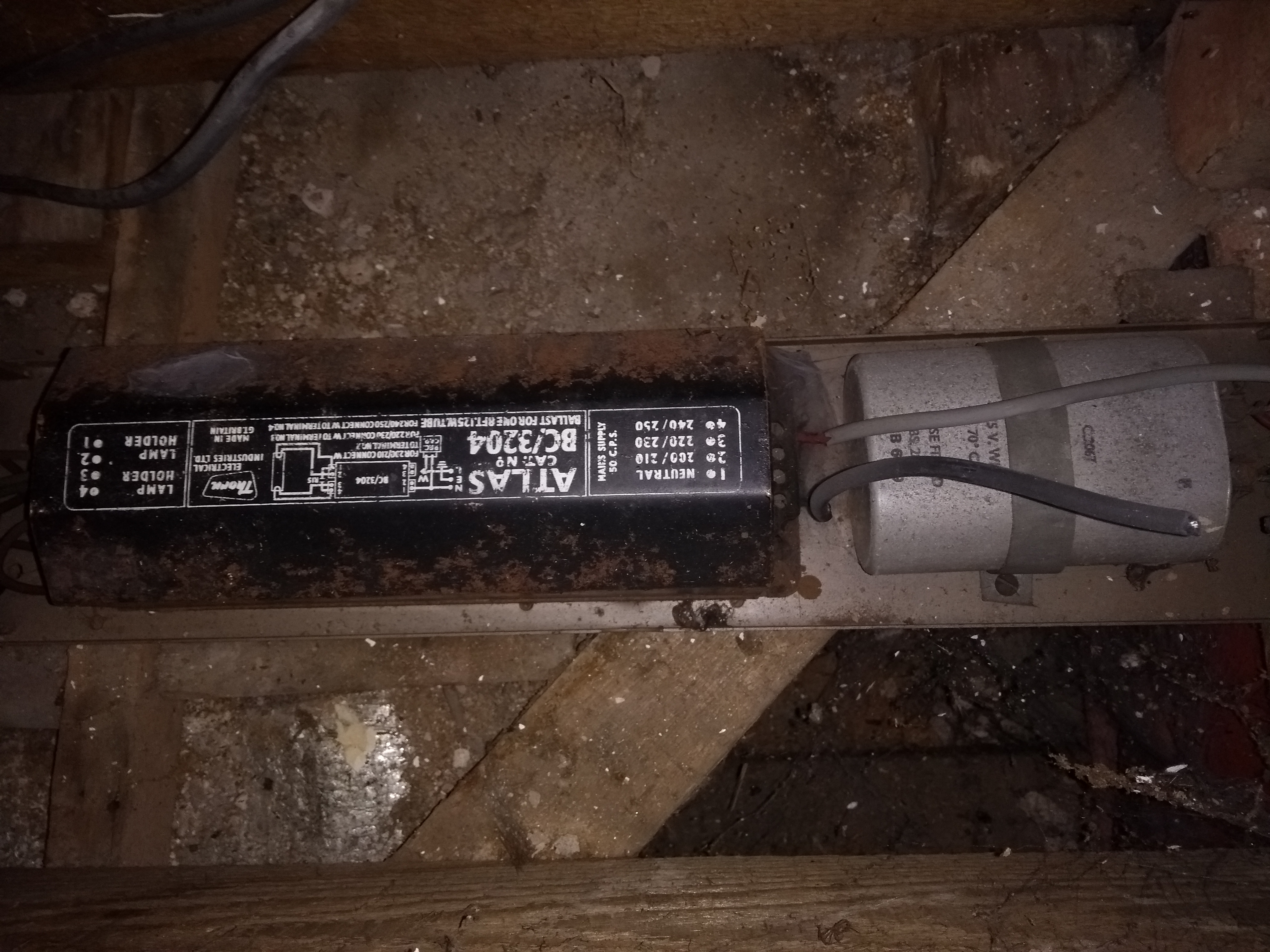

Found this in the ceiling also was interfering just with my continuity test, traced the wire back to this . 1mm cable connected and two lead cables of 2.5. It was a stressful day lifting floor boards.

Is that the guts of an old thorn 8ft brings me back to the first few months of my apprenticeship taking down these old lumps and replacing them with 6fts and I mean lumps just about a 2 man lift to get the bloody thing down:screamcat:
