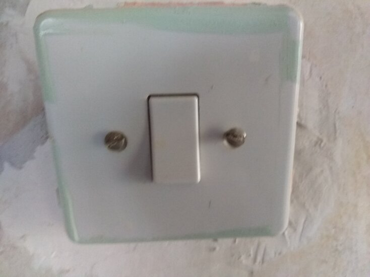

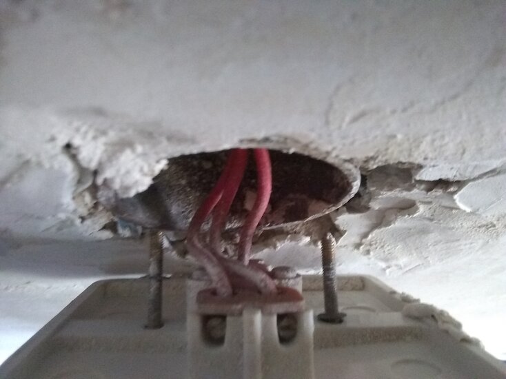

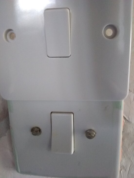

Hi,
Does anyone know if i can still get indoor light switches with the older style 40mm between screws istead of the more standard 60mm between screws? Ive been looking for a while and cant find any, the house was build in the 30's im guessing that was the standard back then.
Cheers

You mean the old circular light switches like this?
I was thinking, they may be grid plate style.
With the inner frame screw holes at 60mm and the screws for the front cover at 40mm.

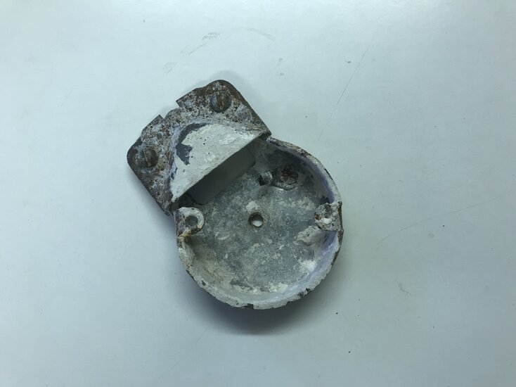

Never seen a switch like that, looks like a BESA box in the wall but it must have an angled conduit entry or the screws will not be horizontal.
Replace the round box with a square back box.
Is there a CPC?
Think ill just add a 20mm box if i cant get the switches, the wall is bad enough unfortunatly dont really want to dig more holes to put the square back box in. Cheers all
