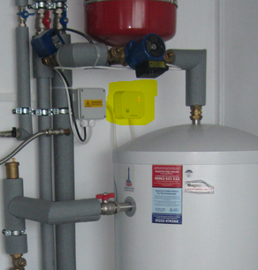

No one in their right mind should be replacing a gas fired heating system with thermodynamics or a heat pump.
Why the gledhill buffer when it's not needed on a system of that size. What type/size is it? looks about 180l. Why are the refrigerant lines not clipped. Why is circulating pump incorrectly mounted. Why has the filling loop be left attached. What is the item highlighted in the attached clip. How is the system controlled?
It's clearly a **** poor design and installation.

I don't think that is a buffer. Is it not the hot water cylinder ?
yes it looks like a mono block system linked in with a 250 ltd hot water tank, with a 15 ltr expansion tank, also looks as thought there is a flow and return pump just next to the expansion vessel. These system really are not central heating, hot water is the only option in this country.
one of them is a zone valve, would be interested to see how they have configured this up to work, plus isn't the flow temperature of these 45-55 degrees? if so were the rads correctly sized. Has the flow rate been correctly measured and adjusted on the pump, I also had a look around this renewable rescue site, enphase is apparently more efficient than solar edge, hhhhmmm show me the data
The tank is a 210l gledhill stainless lite buffer store Stainless Lite Buffer Stores | Gledhill Buffer Stores

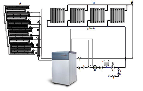

Having checked the energie website it seems that the system should not be installed with a buffer (I wasn't surprised to find that)
We don't know the area being heated. We don't know the construction type of the building so we don't know the heatloss either.
What we do know. The system has not been installed according to the manufacturers instruction/design. It certainly hasn't been installed to an acceptable standard with regards to the cylinder, pipework, pumps, filling loop, refrigeration lines, roof mounting/work.

I reckon the highlighted box is a wireless receiver for tje heating system - it's wired to the pump and zone valve.
Definitely configured as a buffer.
