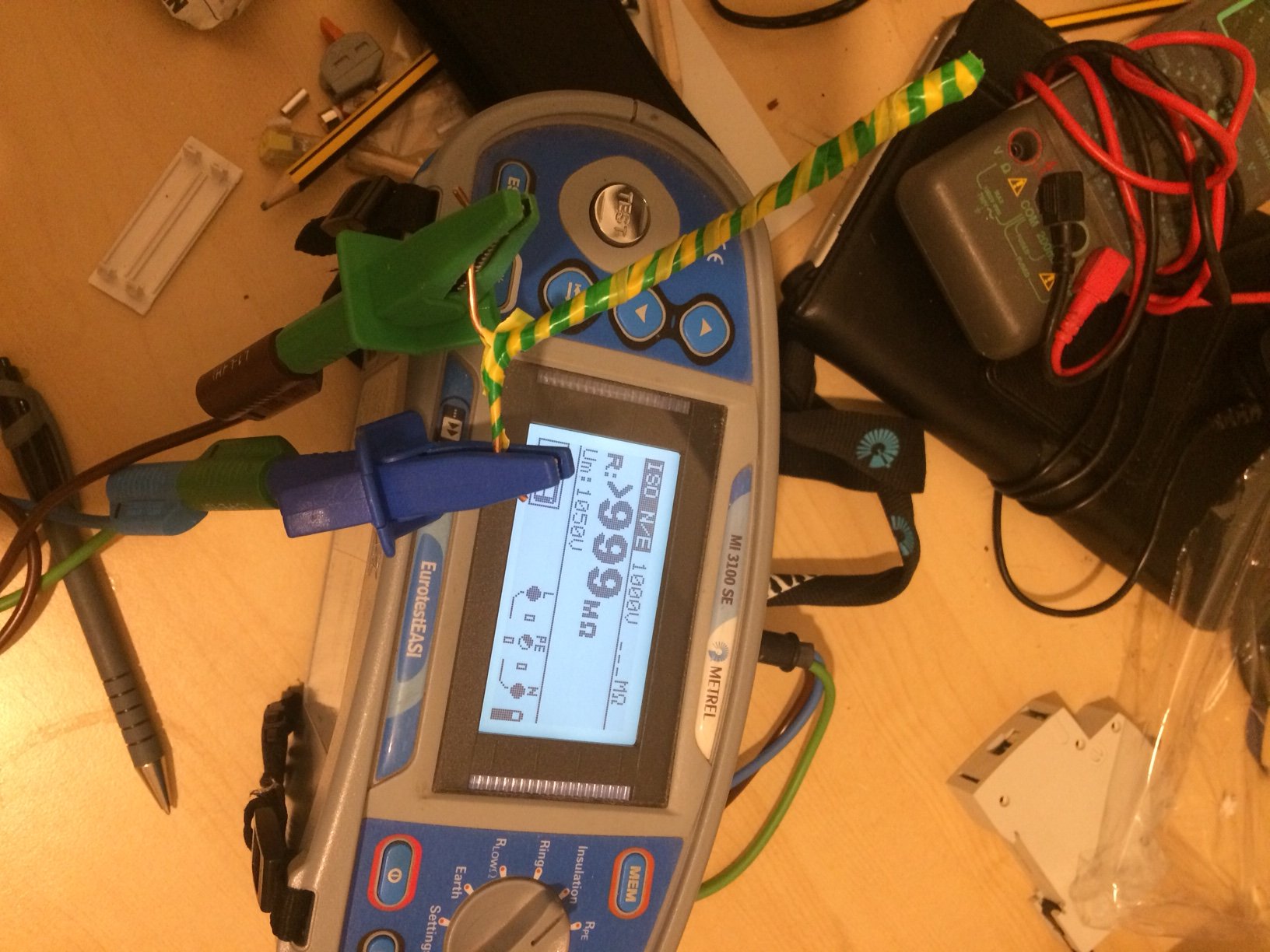

This is 2 bits of 2.5mm one single wrapped with insulation tape then taped together tested at 250 / 500 and 1000v >999mohms
same with heat shrink :)
Hi - it's an interesting question. Extending from @davesparks thoughts in post #3, we need good quality materials, as there may be a difference between what works when you test it and what's good for "10 year performance in a pollution degree 3 environment".
The results of a standard insulation resistance test aren’t really good enough to judge this by.
If the thickness of a single layer of tape was acceptable insulation then cable manufacturers wouldn’t make insulation as thick as it is.
You could wrap a conductor in a single layer of cling film and probably pass an IR test, but that sure as hell isnt acceptable as an insulating layer.
