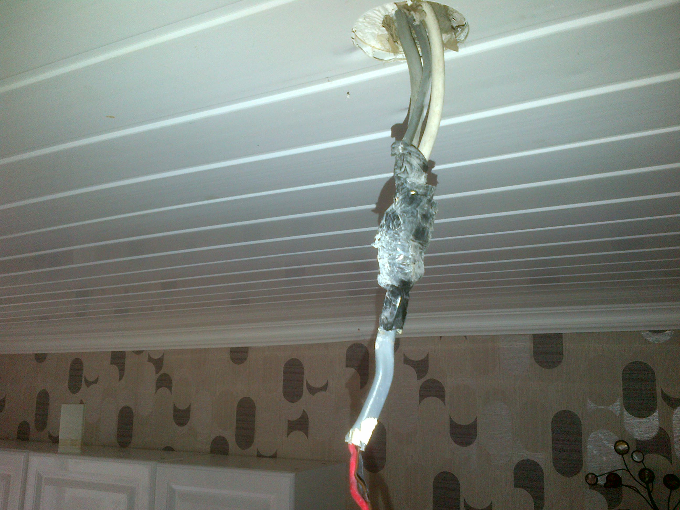

I know that connector block taped looks ---- compared to in a JB but is it really that bad? the reaction to seeing one is always oooft!! terrible. If the taped joint is indoors and in a place where it would just sit there like Tutankhamun never to be disturbed ,then what extra protection would a jb provide? is the pudding joint being unfairly treated in this era of political correctness and the easily offended snowflake electrician???

Those are examples of bad workmanship, not to be confused with a good solid connector block joint that it taped rather than inside a jb

It is neither safe nor practical to inspect or test a taped joint, and as it is not MF then both must be safely achievable. Secondly it is not possible to guarantee the same degree of insulation by on site taping as originally provided by the cable or a properly designed joint box

I would say there has always been an alternative to a choc block connector wrapped in layers of tape. It is not satisfactory in several ways, including aesthetics, testing, safety.
Also, insulation tape glue degrades after a short period of time. Especially if its exposed to varying temperature fluctuations. How many times have you come across a taped joint or chock block and found the "stickiness" of the tape has diminished?
Taped choc block connectors are usually a sign of other DIY 'make do & mend' compromises that you'll go on to find. Undersized cable, incorrectly rated CPDs, twisted together CPCs, cut off CPCs, complete disregard for IP suitability, etc, etc.
