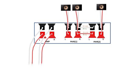

The question relates to using a sound system with a TV on one wall which is perpendicular to a projector screen on another. The TV has Front Left and Front Right speakers located above it ...the idea is to 'switch' the Front Right to becoming Front Left (the projector), and Front Left to a separate speaker.

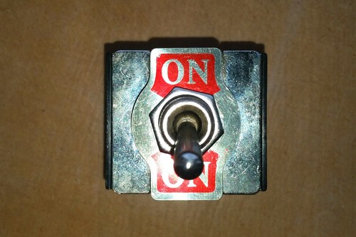

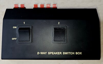

I bought a two-way speaker switch box from Amazon. I guess it is obvious to say that this is normally used to switch the input to two pairs of output.
In my case, I have speaker cable running to a single speaker on Pair(1) Right BUT ALSO 'jumpering' to Pair(2) Left.
As you may surmise, Pair(1) Left goes to a speaker, and Pair(2) Right goes to a speaker ...so three speakers in total.
If I think of this as 'direction of flow' when I select Pair(1), the Input(amp) is directed to Pair(1) Right speaker, and is 'dead ended' to Pair(2).
I turn off Pair(1) and select Pair(2), in which case, Input(amp) is directed to Pair(2) Left speaker, and Pair(2) Right jumpered to the twisted/join in Pair(1) speaker.
Hopefully I have explained that well enough (don't think a picture would actually provide any clarity)
This works ...but, sometimes my speakers just 'cut out'. Strangely (and please don't shout at me), if I increase the volume on the TV, it suddenly comes on and I deafened until I quickly turn the volume down. My initial theory was that it was the amp cutting out, but I considered that turning the volume up shouldn't resolve the problem, and so I believe it to be the switch.
So, my question is 'could this be considered a legitimate use of the switch, or am I doing something so stupid that I should expect it to cut-out?'

If my diagram is sufficient, is that effectively what I am doing?

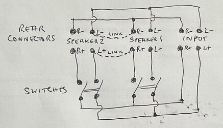

OK, I can guess what is going on here, disconnect it in case you damage the amp. I suspect the speaker switch does not work the way you have assumed, i.e. that it routes the signal to either output 1, or 2, or both in parallel.
Instead, a normal 2-way speaker selector connects both sets of speakers in series all the time, but short-circuits (i.e. bypasses) the speakers that are not in use. If both are selected, it does not short anything, and if neither, it open-circuits the amp. There is a reason that it works this way: With both speakers active they are connected in series so the impedance seen by the amp is higher than either speaker alone, rather than lower as it would be if they were in parallel. Also, with only one set active, the speakers that are not in use are shorted to damp the cones against sympathetic resonance.
This being the case, your problem is not about impedance but about the series configuration of the switching, in which all speakers are always connected to the amplifier even when bypassed. In this non-standard application, the cross-connection for the 'middle' speaker is tying the two amplifier channels together which can damage it, and could cause the cutting in and out that you describe as one or both amp channels go into protect mode and stop fighting each other, or all sorts of unsavoury effects could be going on. What you want to achieve is perfectly feasible, but we will either have to start with a different switch, or modify this one. Please post some pics of the innards and if it is possible to make the necessary modification I will guide you how to do that.
If for any reason your switch does not work the way I describe, we can pursue alternative explanations, but I thought I would jump on that bandwagon in a hurry because of the potential for damage. Possibly, the switch is configured for parallel switching, which is unusual but not impossible. Then a likely explanation for the sound to cut-in at high volume is that the product is substandard, using switch contacts that are unsuitable for audio, which are maintaining a high resistance until a certain minimum 'wetting voltage' is placed across them by increasing the output.

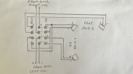

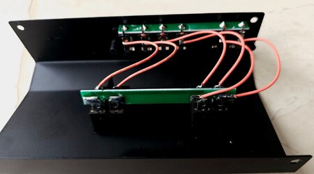

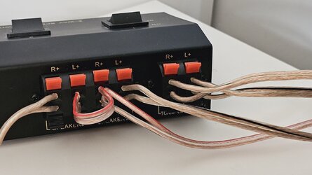

Hi, I cannot apologise enough given your good intentions. I totally appreciate that this was raised in January, and my interest appears to have been lost. Life issues keep getting in the way of my 'projects'. In this case, the switch has not been used for the fear of breaking things, but I would still like to reach the solution. To that end, I have included some photographs. Funnily enough, since taking the unit to pieces, it seems to have stopped cutting out, but that is a limited observation due to lack of use.
NB Stupidly or not, I did actually try switching 1 and 2 on at the same time, and it seems to result in 'all' speakers working (I didn't have the confidence to play with this, as it is not intended use, so no idea if reduced performance, or even if it causes a problem, as I switched back to 'position 1' quickly).
As you will see, the wiring is incredibly simple. As it looks 'secure', I guess the actual rocker switch is not good quality, hence causing the cutting out and my concerns. I would however appreciate your expert point of view, if you can forgive me.
NB You will see I took the pictures in April, and still didn't have time to get back here ... really sorry
Furthermore, the casing is horrible and I didn't manage to align it properly when putting back together (as feared).
