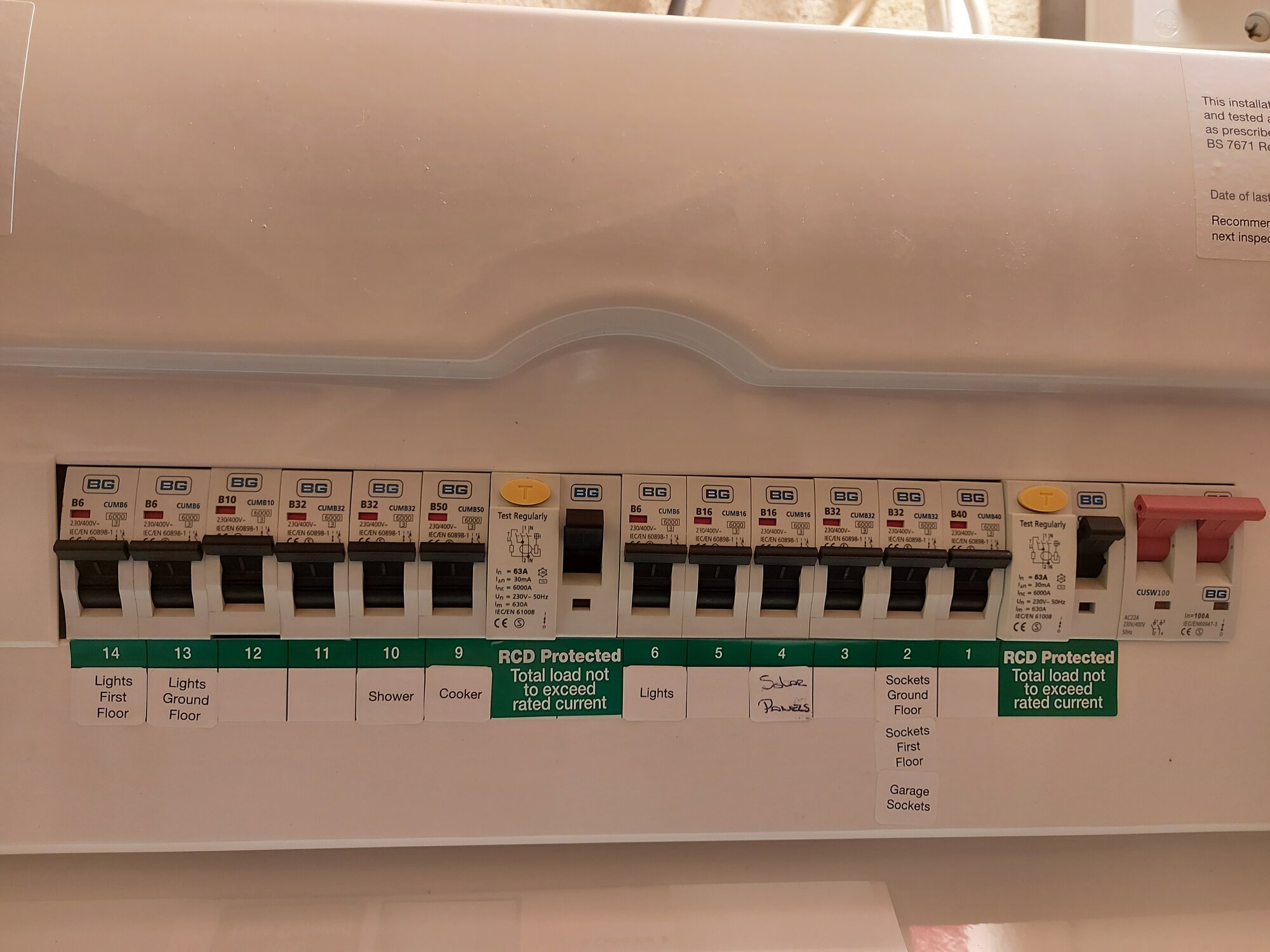

A picture of the new consumer unit with the effected circuit highlighted would be useful.
I have attached a photo of the new consumer unit.
I didnt look too closely at the time, but I now see that many of the mcb's are not labelled.
Does it make sense for me to turn off all mcb's and turn each one on again to identify what comes back to life.

I have also just realised that none of the mcb's are marked as to whether they are on which part of the new extensions.
I think I can be labelled a mug.

If the lack of labelling is indicative of the quality of the install then it may be worth getting someone independent to cast their eye over that.
The lack of testing is also worrying.
Hope you like dogs because it's looking like you've been sold a pup.
(Haven't even mentioned BG either)
Assuming that only the labelled MCBs are in use, then it does appear that there is a lot of sockets on one 32A breaker.
The fact that there are RCDs in place probably means that there is no immediate safety issue, however unless all those sockets are on one continuous ring then it is not likely to be done as current guidance/best practise would want, and there may be an issue that needs resolving to avoid overloading cables...
It's also unlikely that your cooker has a large enough cable to be safely installed on a 50A breaker - though again with the RCD in place it's unlikely to be an issue other than over a long term of continuous overload, which is unlikely in most domestic circumstances.
Hopefully you weren't charged a top rate for what is effectively a cheap Screwfix special board (nothing wrong with that if charged accordingly).
A certificate that detailed the new circuits and testing should have been provided without asking as it is a standard requirement of such work
Under the current Building Regulations, the change of a consumer unit has to be notified to the local Council building control department and usually that means the person doing it has to be registered as competent to do so.
Do you know if they are registered with either NICEIC, NAPIT, or similar scheme? If not, then they would not be able to notify and should you ever sell it may become an issue during the conveyancing process.
If you are unsure, the best approach now (assuming you don't want to call the installer back in), would be to get an EICR (Electrical Installation Condition Report) by another electrician. which would investigate all the circuits, wiring methods and test continuity of rings, etc.
That would give you some peace of mind going forward at least, and may mean that decisions can be made about how to split circuits more appropriately...
