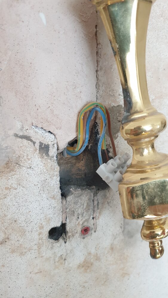

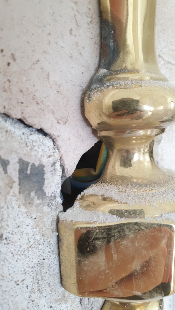

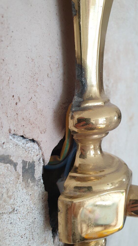

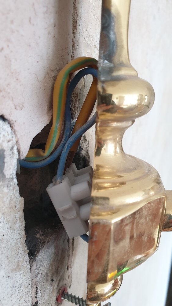

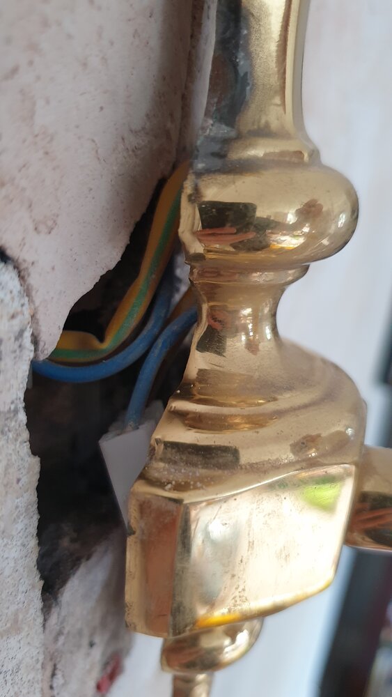

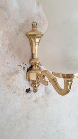

I had an electrician do my house rewire and certain things made me bit trust him. I have 2 wall light fittings in my living room and the electrician filled in the chases to a certain extent. You can see from the picture that the wires run behind the fitting and when the fitting is screwed to the wall the wires look like they are pushed against the wall really tightly.
My first question is, is this safe?
Furthermore, you can see the light fitting is really narrow and old. I have no idea how I'm going to fill the gap between the wall and the fitting, whilst providing adequate protection for the electrics. I would have thought that the electrics would be housed withing a little box that could be plastered over? I dont particularly care about the light fitting..would I be better off buying a newer kind with a circular base that the electrics could sit in to snugly and then the fitting just go over the top of it.
Should the original ectrician sorted this out when he was plastering in the chases?
Sorry..im really useless when it comes to this kind of thing. I just want to know the best and quickest solution so I can finish decorating the room. If it involves paying to get an electrician in sort it then I'm happy to do that.

From what I can see from the photos, the wires are getting traped/pinched behind the fitting, soe Maint free connectors would be better also a larger hole behind the fitting, remember if you are using wet filler isolate the lighting whilst filling. My point about the "was he an Electrician" highlights that he shouldn't leave it like he did.

It is sometimes difficult to do the connections on that type of light fitting but i always tended to flush an architrave metal box into the wall behind such fittings.
Usually plenty of room for any connections then and much neater although a little extra work.
+1 for Paul L. A metal architrave single box behind each fitting will allow the wall surface to be made good and safely enclose the connections. Not for DIY though - you will need a professional electrician.

Absolutely horrible lights to install given there is hardly any room to dress the connections.
architrave box sunk in , made good with filler then put light up....(in that order)
Absolutely agree totally naff light fittings but as said in post #12
An archtrave box would be a slightly better job but would still be exposed and you would have to even partially fill in the corners of those with plaster too
I have never seen arch boxes installed for wall lights like that so far, just a bit of the plaster dug out and the cabling squashed in
Best and only method for this situation would be to throw those lights in the bin get some decent ones that give your electrician half a chance of doing a proper job!
I'd use a plastic conduit box with a hole drilled in the cover and rubber grommet, would have a hard job to see it once it's decorated and painted, wallpaper even better, does anyone wallpaper anymore?
Those are not easy lights to work with, but the electrician should either have done a proper job, or said he couldn't fit hem...not leave them like that
through crimps and heat sleeve over the joint would have been another reasonable solution ?
(but I still wouldn’t have been overly happy with the joint squashed into the wall)

Also, could have sourced some brass screws to actually fix the lamps to the wall. We’re these replacing old wall lamps and repositioned slightly?
They are the same qall lamps that were there before..looks likenhebdid reposition them, but I dont know why.
I thinknIm just going to buy new fittings and get an electrician in to fit them.
