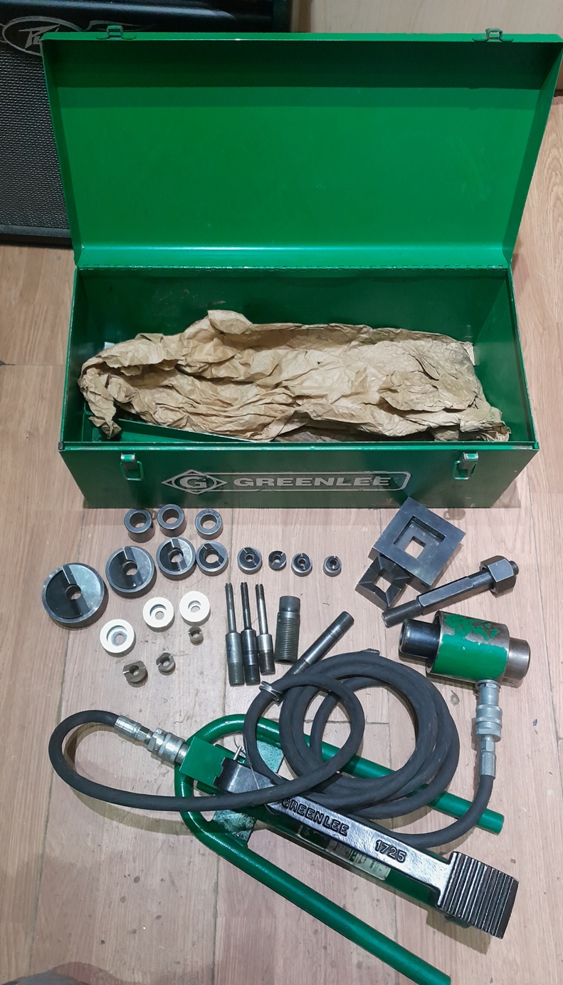

I use a Greenlee hydraulic punch set for most things. This kit has punched so many holes since I bought it. Fairly recently got the heavy duty parts for punching stainless in the smaller sizes as we started doing a lot more stainless work. Great at producing burr free holes, much safer than a holesaw too. The square punch is an awesome timesaver when it comes to cutting trunking entries in distribution boards. I wish I had more square sizes but I just can't afford them so have to use it for each corner to make up the size. Still faster than messing about with a jigsaw or whatever and much gentler on modern flimsy steel enclosures often found today. Bring back cast iron!
