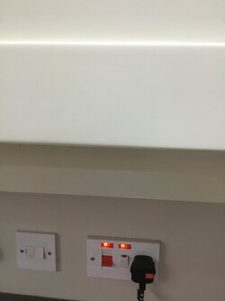

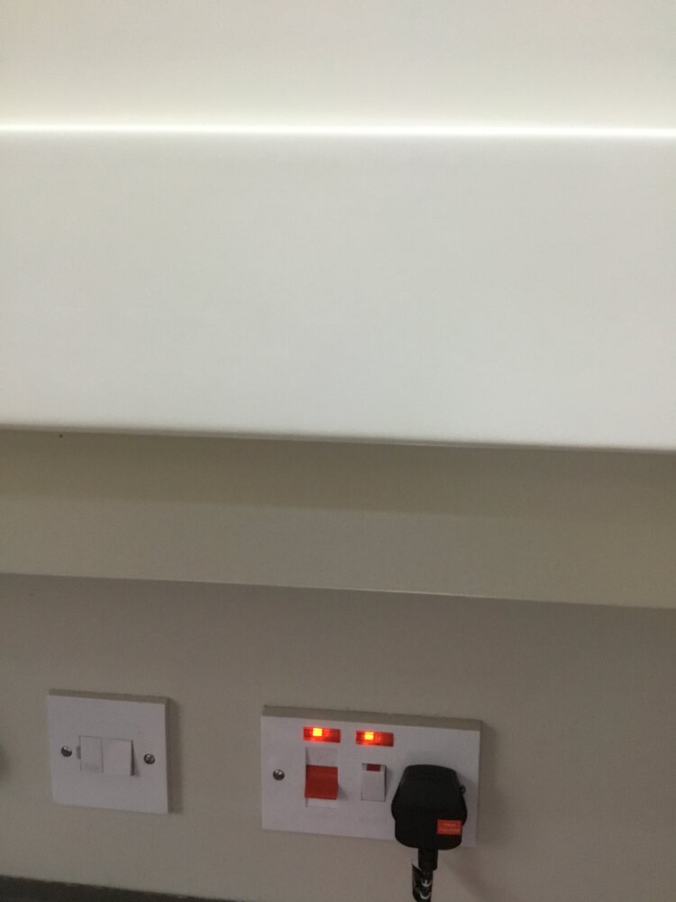

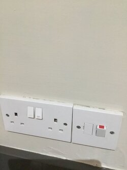

Kitchen I rewired a few years ago , put a new dedicated ring in and new cooker circuit. No need for a grid imo.
spur next to a socket looks fine imo

20A D/P switch (with or without neon) above w/top. single socket for appliance below. that way you don't have 2 x 13A fuses in series. as Punch used to say (before he was declared a non-PC wife-beating sexist)That's the way to do it.
edit: to the pc brigade... i should have said "genderist".
Where would I have 2 x 13A fuses in series?
One in the fuse connection unit
One in the plug of the appliance
