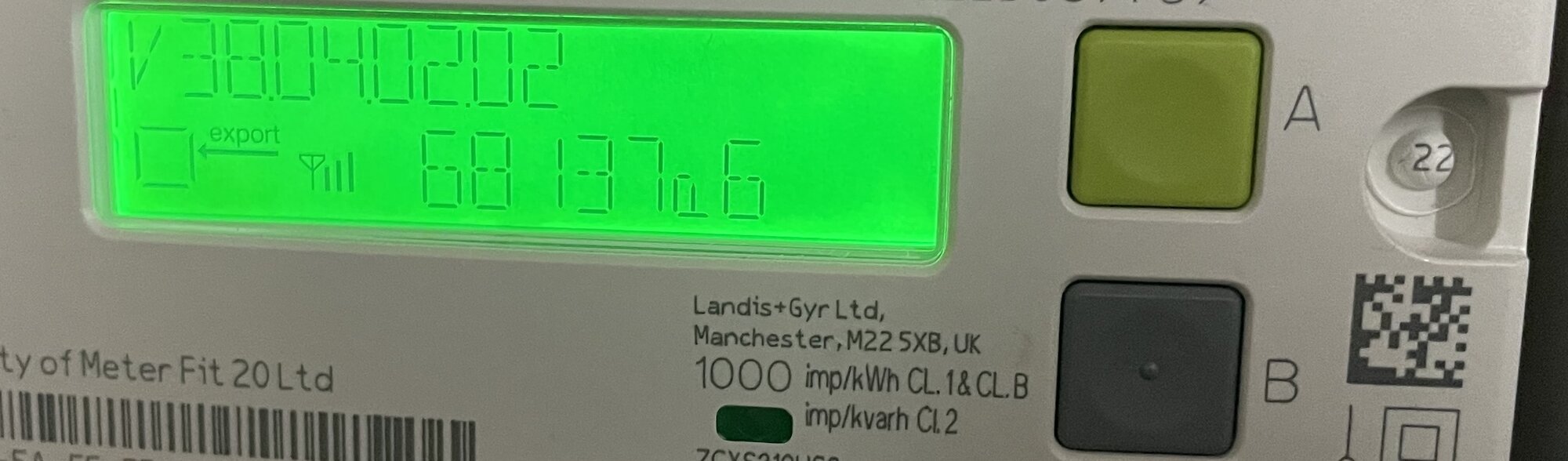

Similar issue to yourself. Meter is stuck on rate 2 act imp, red light flashes every second, IHD cannot communicate and A/B on the meter do not work. Will report it to my supplier
Your meter just needs small power cycle to work and communicate with your energy provider and home iHD device again. Best way is to speak to your supplier and ask for engineer to do that for you. Other option is to speak to DNO and ask them to do that. My meter got stuck but luckily we had power cut and when electrics returned all was working fine. My meter was off for couple of days and did not register any usage for that period. Hope that will help.

Interestingly they just swapped my meter out, after making a quick call to check that no readings were being logged (DCC I guess?). No readings had been logged since I went through supplier of last resort, British Gas only charged me the standing charge for that period.
