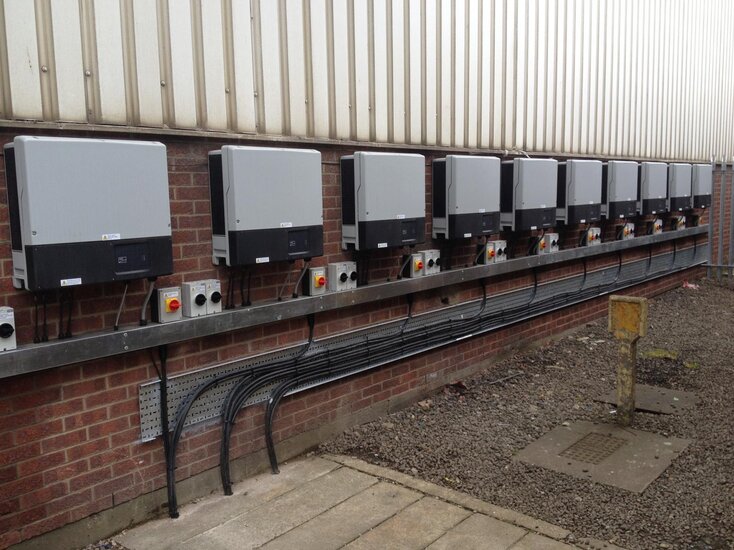

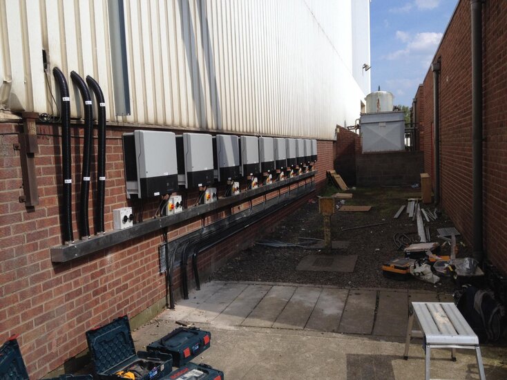

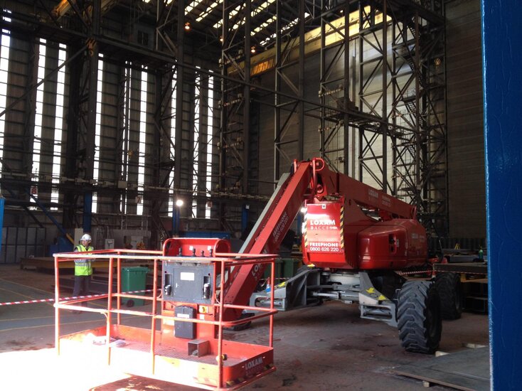

A nice pv job from a couple of weeks ago .

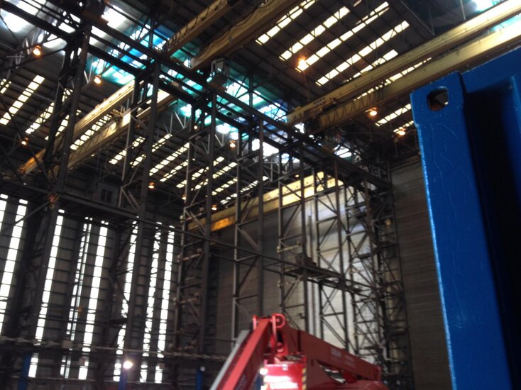

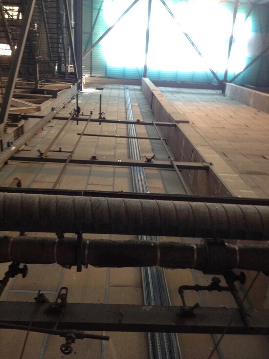

Tallest roof i have ever worked on at 42 metres which made the dc run difficult .

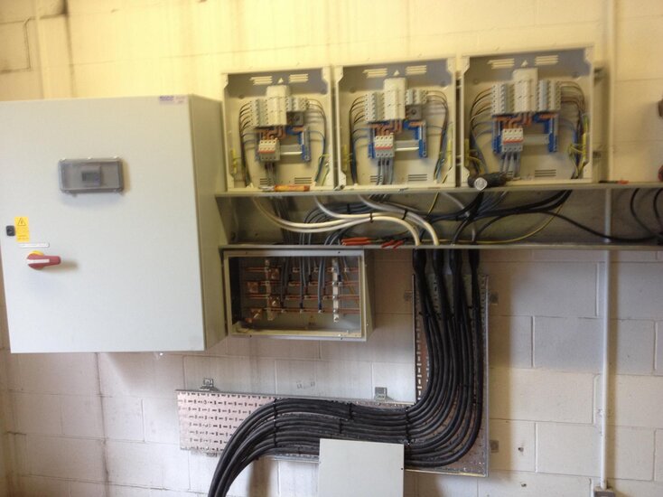

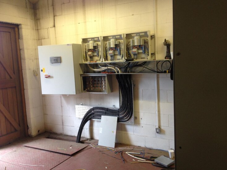

The ac side was easy in comparison with small short runs of swa . Enjoyed installing out in the sunshine which didn't
last long as the week after it ****ed down with rain and we were in a field doing a ground mount :cry_smile:
I'm sure there is a good reason but why install a bussbar and 3x 4way DB when 1x 12way DB would do the same job?
I guess it could be that 10 of your PV units would overload a 125A DB, but then a 250A DB or a panel board would do wouldn't it?
10 x 20kW inverters = 200kW, or around 280-290A per phase.
probably more cost effective to go the buzz bar plus 3 x 100A boards than going for 1 300A board.
In other news, I can't get my head around how that can possibly be 42m high, no chance that cherry picker would get anything close to 42m, and I can only count 5-6 storeys on any of the pictures. 42 feet high sees a bit more likely.
It looks to be around the same height we were working on last week which was 14m to the gutter, 18m to the ridge.
