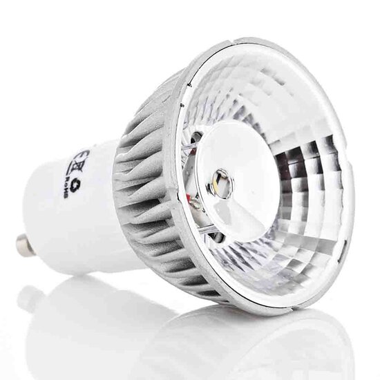

Look into ones that use the SMD 5050 chips, great output from them at a low wattage.
Nice spread of light off them as well unlike the high powered LED stuff which can be very direct.
I am using the above LED lamp, the light output is really good, so much so I have also installed them at home, however, they just look pants when off!
