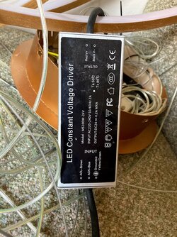

The light works, so is it normal for the transformer / driver to produce such heat (it does radiate quite a lot of heat)? Is it actually faulty?

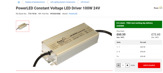

With regards the transformer temperature, it is a tough one to discuss as unless you feel the heat we are unable if it is normal or not. Interestingly aftermarket parts are available, a replacement transformer I have seen (same characteristics) for £70 (pics below). But not knowing how they're suppose to perform in terms of heat output, i'm struggling to justify the potentially unnecessary £70 outlay.

I have a very similar fitting and have had no problems running it on a B6 breaker and the driver dissipates no heat as such. If your driver is getting so hot it may well be underrated and not fit for purpose. Being only six months old and having proof of purchase then I would be in contact with the supplier, the fact you don't have the original packaging should not be relevant. Did the electrician say what the fault was with it.

Oh this is interesting... the electrician whilst disconnecting the fitting responded to the heat and said it was faulty. It is really interesting you have no issues on a B6 breaker - same as mine. Perhaps it is indeed the transformer then.
Think I need to contact the supplier.
The symbols on the driver indicate an operating max temperature of 100 degrees, and a case temperature of 80 degrees.
Hi, yes I saw this too and of course means i ought to expect heat as should the electrician, without being able to measure the temperature it is difficult to confirm whether it is at temp or above temp. It can be felt on the face whilst fitting the fixture. It seems it may be working as it should???

Thank you for your reply and advice, we have since contacted the supplier with an initial positive response of offering to send our a replacement driver/transformer (as that is what we said was at fault). This is very promising and much smoother than I'd thought.
