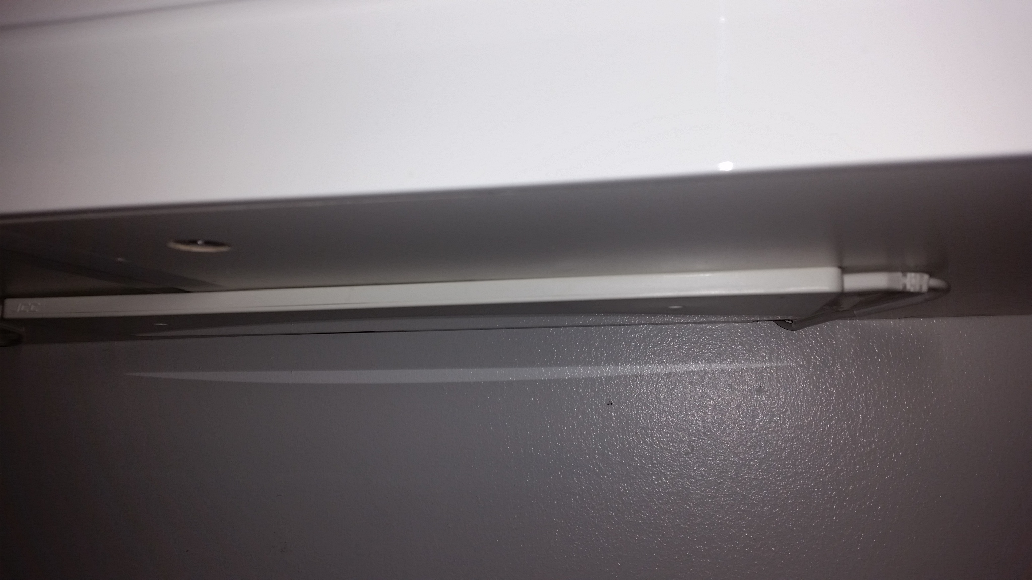

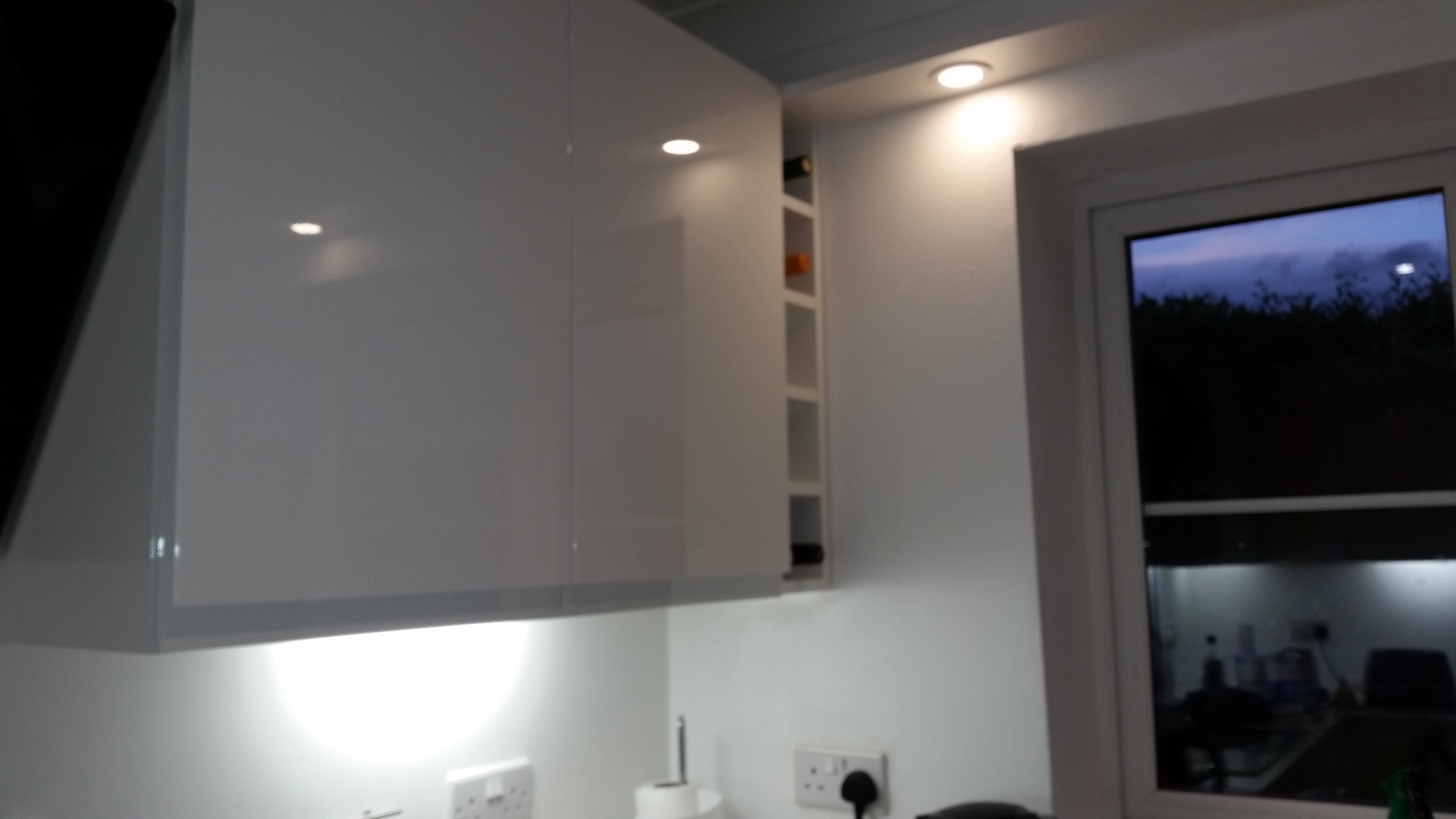

I fitted these recently. Cannot remember the make but got them from Denmans. They're only about 5mm thick and perfect for underneath cabinets where there's no pelmet...transformer is on top of the cupboard. I wired them back to the kitchen light switch so control is right next to the door - as you'd expect...LED possible strip lighting above worktops (under wall units) ultra thin LED lightin - EletriciansForums.net
