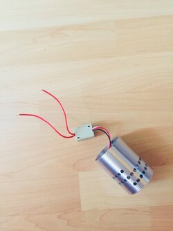

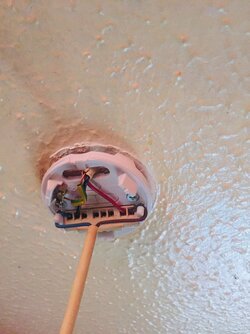

Hi everyone. I’m new here. If anyone can help me; I’d be very grateful. How do I fit these lamps to a ceiling rose? As you can see, the two wires coming from the lamp are the same colour.
Have you got the screw on base for it. I'll be honest I would not consider putting anything like that up in my property I suspect it is of dubious quality.
It doesn't fit to the ceiling rose that needs removing. The base plate screws to the ceiling then the fittings screws onto that. You then need an electrician to correctly connect it in the ceiling void.
That tiny box I believe is the driver. I know what I would do with it.
