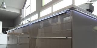

Please could you tech savvy people advise a novice which products are recommended for LED strip lights for a Kitchen
1) under a worktop of about a length of 6m
2) Under wall units of about 4m
3) Also under worktop for an Island (Island length 3m) possibly the full perimeter (7.2m)
The kitchen layout is an L shape with an Island:
I would like to set them up so they are all connected together to a single PIR sensor on the ceiling in the middle of the kitchen and can be also switched off completely with a wall switch. Can I also use a remote to change the colours with this configuration?
What configuration of wiring would I need for this/ materials/ products.
Any help/ links/ pictures would be greatly appreciated,
Thank you in Advance
If your kitchen is 2.4m wide and the worktops total 1.2m wide that will leave you 1.2m of space to move in. As the island will be placed in the middle of that it means you will have circa .6m either side of the island? Anyway what you are proposing can be done but specifying it would depend on your budget. You can get strip LED at £15.00 per meter or £20 per meter for RGB with remote. A switch on the wall as a master switch is not a problem with a PIR as a secondary switch. Maybe Lutron controls for the remote part. Seems like you are looking at around 21 meters of LED strip which comes out at about £450 plus Lutron remotes, or you can get them with the LED RGB type. The wiring and fitting around 2 days from what you propose. Cost around £500 labour, so not much change out of £1k. I suspect you may change your mind on design though as you may wish to switch the different level/location lights separately so another day for such a configuration @ £250. per day.
