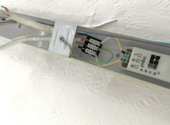

I’m replacing a fluorescent tube light which had an electronic ballast fitting - I’ve ripped this out and plan on fitting an LED tube instead.
There’s two wires coming out the either end fittings - do I just twist these together and put them in a block and then connect the feed to it or is there another way I should be doing this?
Thanks!

Your Question is a little vague? I presume you had a Fluorescent Light Batten fitting, and you have removed all the internal gear to allow a LED tube to be fitted. They are all different, the energiser LED tubes have L & N go to one end of the lamp, So the two wires the other end to keep tidy, you would put each one into a separate connector block or even better a Wago connector. Make sure the Earth wires are still all properly connected in the relevant terminal.
The energiser LED I have doesn’t have L & N written on either end so I wasn’t sure if it needed to be connected on both ends or just one, assuming just one side as you said if I insert it the wrong way round would it blow the tube? Or does it work both ways? The earth goes into the same block as the L/N I assume :) Thanks
