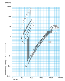

But when it comes to coping with the overload under fault conditions the situation is rather different. The let-through fault "energy" (the I2t term) for an OCPD generally increases at small overloads because the 't' term increases much faster than the 'I^2' term decreases.
So for fault conditions a long cable can end up suffering more thermal stress because it took a lot longer for the OCPD to disconnect. For a fuse the curve is fairly simple, dropping down and flattening off as you get to the worst-case PFC actually having the least I2t term!
But a MCB is a lot more complex, and it depend on which region you are in (thermal trip, or "instantaneous" magnetic trip). Here is an example from the Hager commercial catalogue:
You can see that when you hit the magnetic trip region at {3-5 * In} then the fault energy drops massively as the disconnect time drops from 5-25 seconds to tens milliseconds or so.
However, unlike a fuse the MCB does not disconnect that much faster as PFC increases to allow a shorter 't' to offset the greater 'I^2' aspect. So once you get beyond a couple of kA fault currents then a similar rating BS88 fuse lets through less energy.
