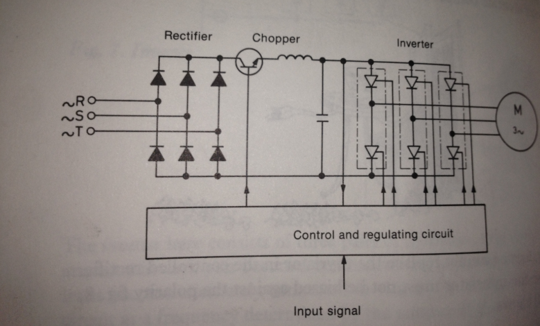

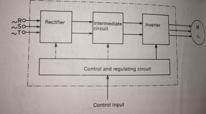

here's one i did for a 3 phase speed control:
oops, upside down.

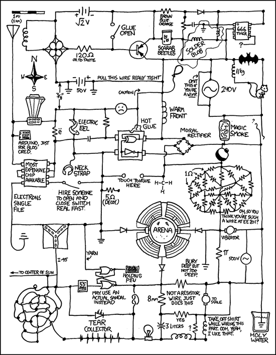

I've tried knocking this circuit up, but it looks like I'll have to wait for the next space mission for my final connection to the sun. Also the holy water took some finding

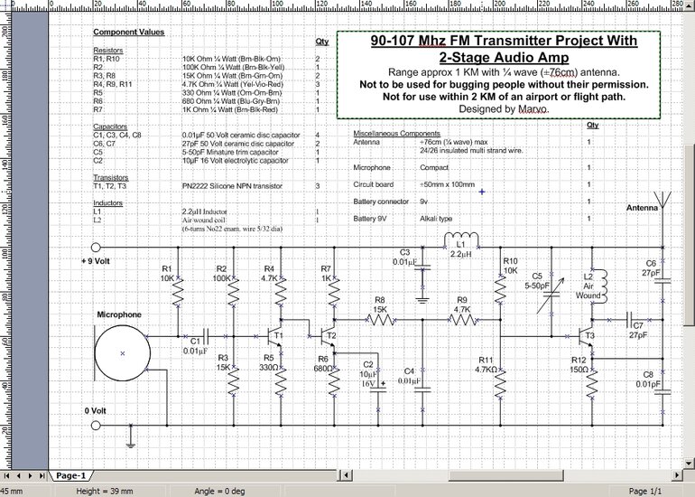

Are you thinking about circuits or general schematics? I can't post drawings from work but here's an FM transmitter I made with one of my kids for a school project
Both, as I realise not many people here will be designing their own circuits as above, most are domestically biased from what I've seen and this sort of project's unlikely. So it gives everyone a chance to post anything really. :wink_smile:
