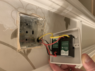

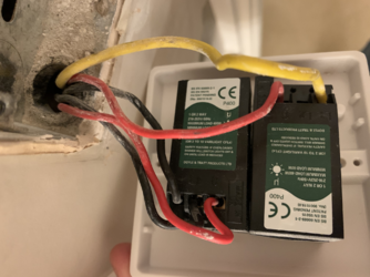

Hi all,
DIY homeowner. Any advice gratefully received.
I've recently moved in to a property. Electrics are of variable age including some old lead sheathed cabling, some back boxes of cast iron conduit type. Had an EICR done (I was at work frustratingly so couldn't ask questions as they went round). They've sent over the report which has a number of C2s but whenever I ring to try and actually speak to an electrician from the firm about it I can't get past the receptionist and the promised call back never arrives... Will definitely need some rewiring done but trying to work out how extensive (I had hoped paying for an EICR might answer that question but it doesn't seem to have done).
One light switch in particular is currently causing me grief. All other switches upstairs have earth wires attached (either to the back boxes where they have been replaced, or to the converter plates where the old cast iron conduit boxes are still in situ). This switch has two dimmer dials, with one dimmer part of a 2 switch system for the light on the stairs, and one dimmer controlling the bathroom lights. There is no earth that I can see - certainly nothing attached to the screw on the back box. Photo attached.
Should there be an earth or is it possible that the old conduit acts as an earth? I will be getting a professional in to do the rewiring and attend to the C2 items when I can (getting a tradesman out at the moment is proving challenging) but I'd appreciate advice on if this switch is currently safe.
Thanks

it's quite probable that the steel conduit was used as cpc(earth). if it'sstill intact and gives acceptable resistance readings, can be left as is.

Note 6. He says ALL switch backboxes old type, but your picture shows a regular (modern-ish) galv box. Also, you wont have grommits if there's conduit going into the box
