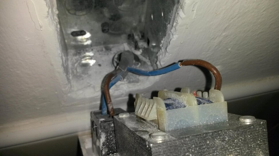

Recently I got called out to a similar install with 13a sockets instead of 2/5a's. During a dinner party they'd plugged in a 2kw fan heater....untill someone noticed the dimmer switch was on fire!

However if there is a 13A outlet in place of a 5A outlet (I think this is the case here) on this lighting circuit, then it must be a C2 surely due to the lack of co-ordination between potential current draw and rating of accessories such as light switches. The dangers are pointed out ably by wirepuller's example in post #5.
Yup - I didn't really mention that on the EICR as the client commented about a problem and wanted it fixing!
