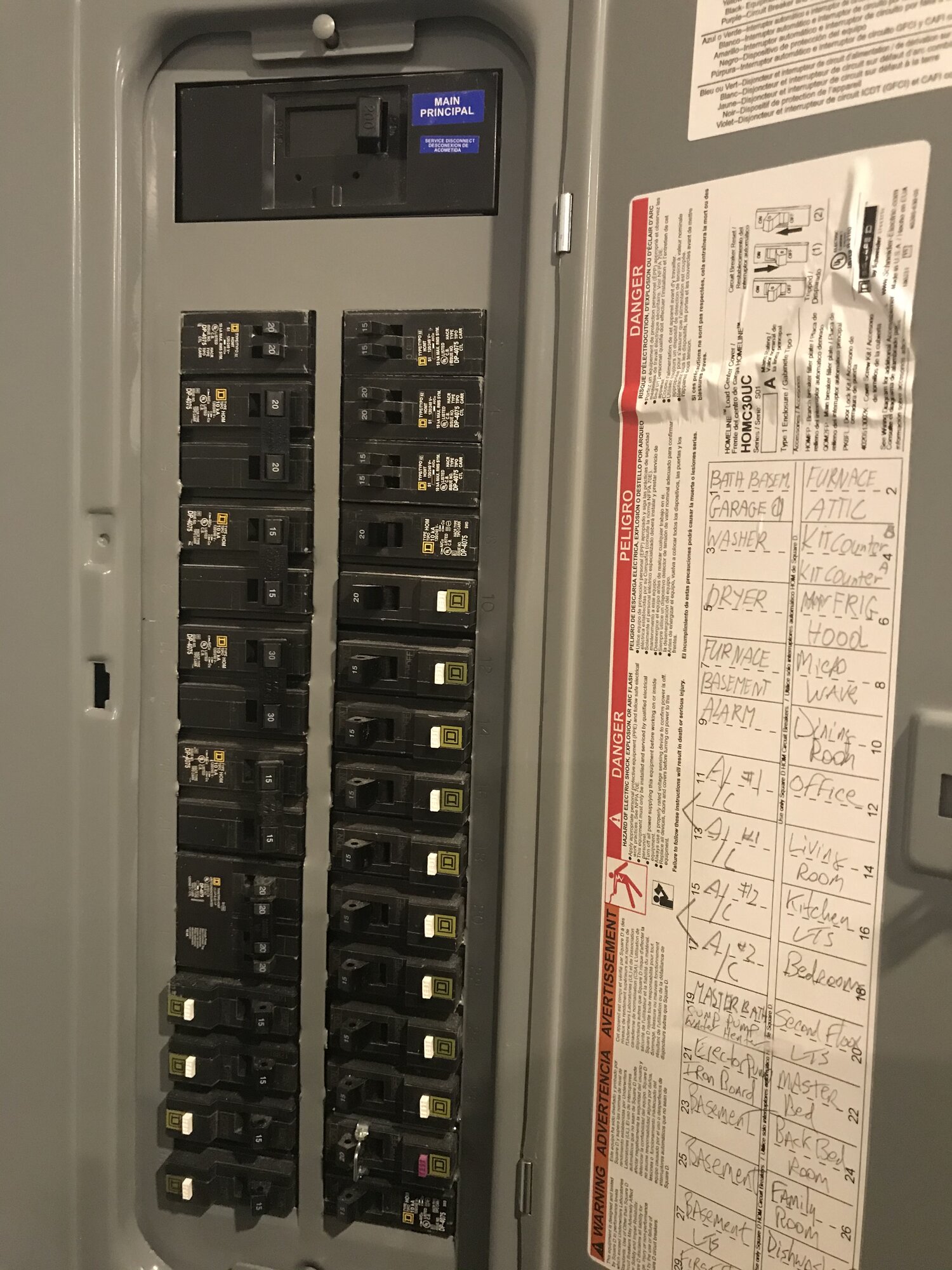

Looking to possible add a double breaker in the box to open up some space for a swimming pool without needing to add a sub panel. Any advice on breakers they might sell?9D4B93BE-BC51-4A09-A81D-8C95A1CA47EA.jpeg
Looking to possible add a double breaker in the box to open up some space for a swimming pool without needing to add a sub panel. Any advice on breakers they might sell?View attachment 83930
You will have to install more slim line breakers to free up enough space which is a 1/2 inch breaker instead of the 1 inch breakers. You have to purchase Square-D type QO homeline breakers for that panel.
