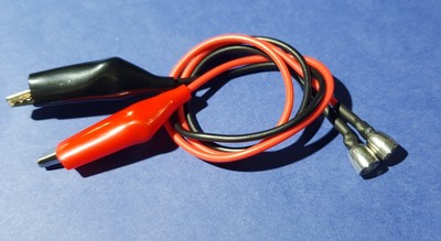

I suspect that these, with a bit of heat shrink, and a spare PZ2 bit would do the job equally well.
£3.99 for two of them, shipped! I'll report back...
Just to say don't bother with those - feeble magnet, nearly useless.
