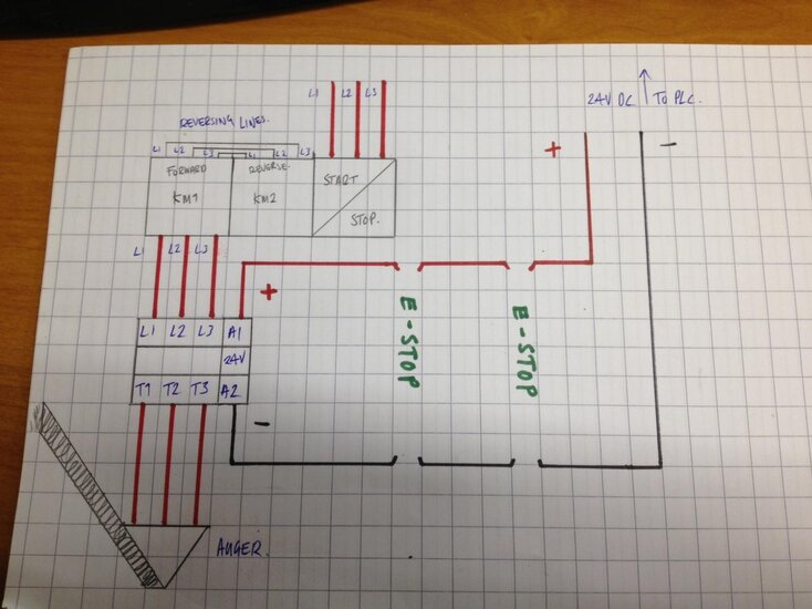

I have just put together an E stop circuit that is integrated into an auger motor control circuit w/ forward/reverse DOL. I have posted this awful diagram on another post but i am having some trouble when i put 24v down the + line and getting a readying of 0V as soon as it hits the first E stop.

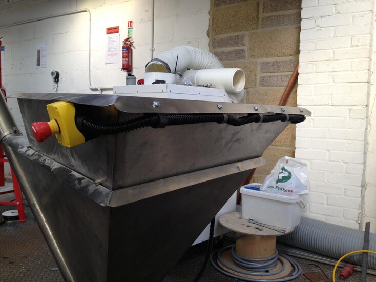

The 24V signal will actually be supplied by the PLC module, but the PLC chap has yet to come in and finish off his work so i wanted to just test mt circuit prior to his arrival and put 24v down the line. I was getting a voltage until it hit the first E stop which is located on the side of the auger hopper.

I have a 24v DC mini contactor relay in the adaptable box with the E stop circuit coming from the A1 and A2 ports in tri-rated 18AWG cable, the circuit continues round to the second E stop the other side of the hopper and then will carry on to the PLC when its ready. When the PLC calls for product it will send the 24V signal through the line, through the E stops and onto the contactor, energising the coil and closing the circuit. That's the plan
But like i mentioned, even after putting 24V down it, simulating the PLC signal, when it hits the first E stop, i just lose voltage, and get nothing?

Are the guards Fixed or Interlocked?

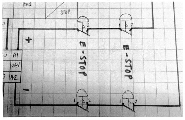

Well i have wired them as such, + to terminal "1", - to terminal "2" and so one then just daisy chained on to E stop number 2, same terminations in that switch (only using one of the N/C contacts on each E stop) and then out to the PLC.
Are the guards Fixed or Interlocked? Important question.
So you have 4 EM Stop Pushbuttons. Is it wires like this: (done in a rush)

Spoon, thanks for making better clarity of my awful drawing, i have 2 e stops, i just drew it badly as i don't know the correct way to drawy diagrams i apologise. So i only need to take one feed from A1 across the E stops? and then take that feed back to the PLC? I just assumed i needed a + and -. my inexperience getting the better of me again.
I think i have been a total fool. I have over looked the insanely obvious....... i shall take myself outside and beat myself with a cricket bat.

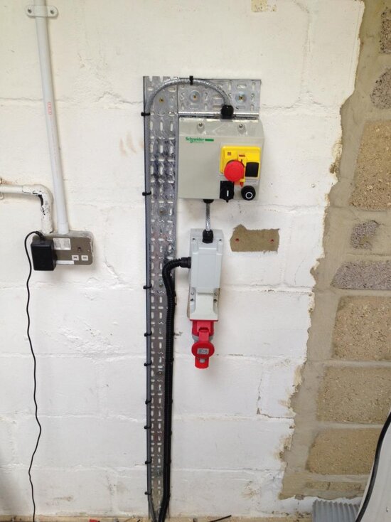

To improve the tray mount it on brackets rather than straight to the wall, then you can get cable ties behind. Also manufacturer the top bend rather than just sticking two piece's side by side. Will look a lot better and more professional.
Now I'm not calling your work as I don't like doing that, its just tips for next time :daisy:

But basically your e-stops are just a daisy chain in line to your a1 or coil + on the contactor.
